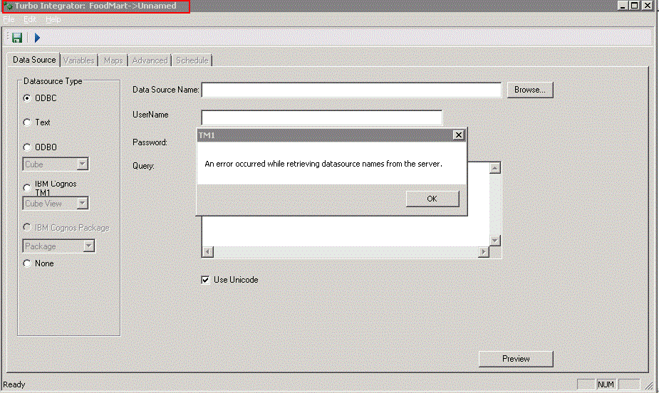

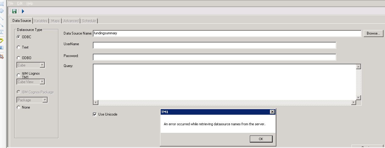

I was trying to use TI to import Dimensions/Cubes.
When I select the ODBC and click browse I get an error: An error occurred while retrieving datasource names from the server.
Attached is the error I am getting. Please advise.
I do have couple of more DSN's, because it is 64 bit. I tried both 32 and 64 bit and ensure there is a DSN available.
%systemdrive%\Windows\SysWoW64 folder and %systemdrive%\Windows\System32 folder.
Ganesh
Ganesh
- tm1_error.jpg (63.76 KiB) Viewed 10000 times

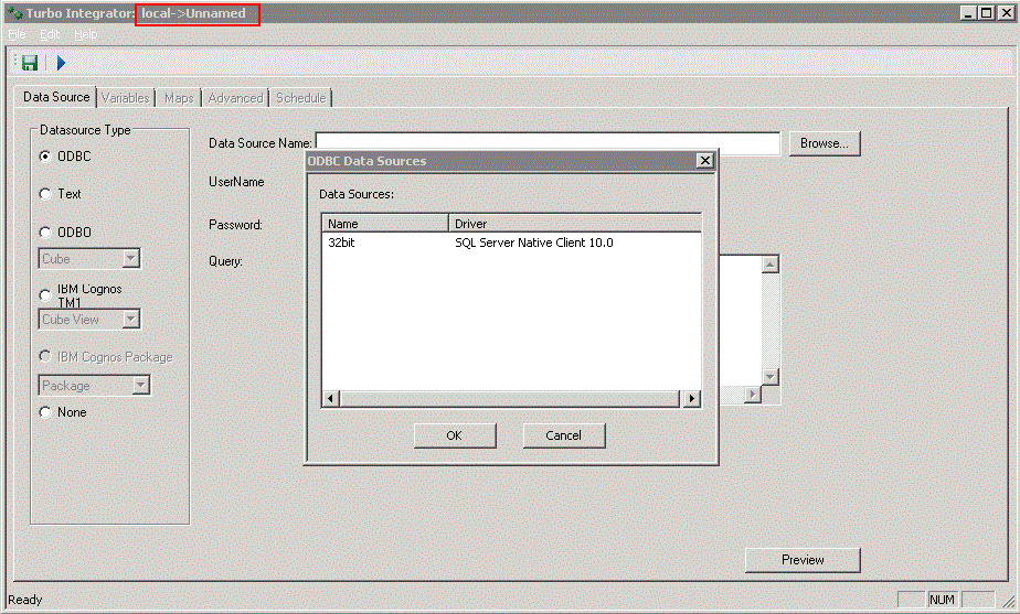

Later, please see below screen shot. Ironically the local server is able to hit the ODBC what I was trying to connect but not the application server
in my example FoodMart.
I have created in both ways with different names.
%WINDIR%\System32\odbcad32.exe
%WINDIR%\SysWOW64\odbcad32.exe

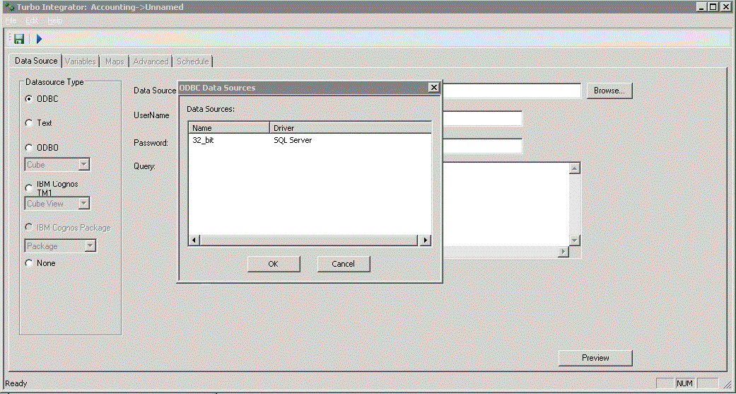

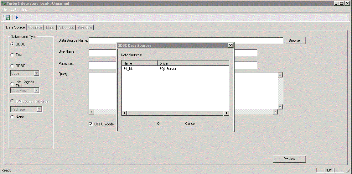

For the benefit of others, few more clarification.
1. On a 64 bit Cognos TM1 on top of Windows 2008r2 x64 , local server uses 64 bit driver of the dsn and the application server
uses the 32 bit driver. Please see screen shot below 2. Create System DSN, in my case I was wasting time by creating user dsn. My bad.
3. Certain things about Oracle on Windows 32/64 bit.
Microsoft do not have a 64 bit driver(MSDAORA which is 32 bit) connecting to Oracle, in that case you have to install the 64 bit version of Oracle's Driver (OraOLEDB.Oracle) and on top of OraOLEDB.Oracle have to create the systemDSN.
So you have to decide if you are going to make a connection to Oracle on the Local Server or Application Server created by you.
