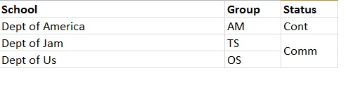

We are using Cognos Tm1 10.2 and are experiencing some weird data formatting in Cube Viewer, Contributor & TM1WEB.
When we open a cube in cube viewer and drag multiple dimensions as rows, duplicate columns are not being separated by the first dimension, refer to attached screenshot.
(FYI - Status dimension has two columns - Cont and Comm).
What we would expect is similar to that of TM1 9.5.2 where status would be displayed as Comm for both rows as they fall under different schools.
Is anyone else having this issue in their environment? Any workarounds or tips?

I do not get this in architect or web cube viewer (in 10.2 or any version). The attachment you've uploaded isn't of a cubeviewer, could you please take a screenshot of the cube view in question and post that?

Re: TM1 Cube Viewer 10.2 Diplay
Might sound simple but that kind of view leads me to believe zero supression has been turned on and you arent showing all elements for all combinations.
Perfecto! Turning off Zero Suppression on all rows did the trick! Thanks PlanningDev.PlanningDev wrote:Might sound simple but that kind of view leads me to believe zero supression has been turned on and you arent showing all elements for all combinations.
Apparently this didnt happen with 9.5.2.. Interesting. Im still quite new to the Tm1 development space.
