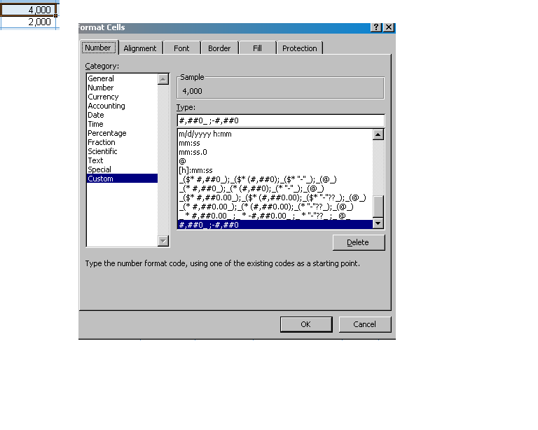

Users maintain an excel sheet where the custom format for the value(number) is used as #,##0_ ;-#,##0.
When we try to copy the value from excel to cube in tm1 architect, it works fine.But the same value when the users try to copy from excel to tm1 application web, it throws the below error.If they change the format in excel to standard number format, the value can be copied.
Unexpected number format:9,562
Please use the following decimal and group separators; (#,###.##).
Could you please tell me if the custom format in excel ' #,##0_ ;-#,##0' is supported in tm1 application web?
Is there any workaround to copy the values(with above custom format) from the excel directly into tm1 application web?

I am trying to copy the data from ordinary excel sheet into cube view in TM1 Application Web (earlier known as TM1 contributor).
In excel, if you double click the cell,it will show as '4000'.Since the format is given as below, it appears as '4,000'.
I try to copy this value '4,000' to cube view in tm1 application web which throws the error.

- Number format
- Formatting.png (22.84 KiB) Viewed 4987 times
