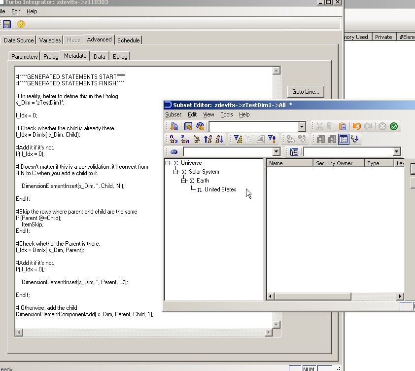

The code works fine if your hierarchy is in order. But if the parent child table is not in order, there's a problem.
If my hierarchy is universe-->solar system-->earth-->united states suppose my parent child table looks like
Parent | Child
Universe | Solar System
Earth | United States
Solar System | Earth
When I run the code sample above, Earth never gets assigned as a child of Solar System. What am I missing?
Re: Load Parent Child Hierarchies from ODBC into TM1
braypa wrote:The code works fine if your hierarchy is in order. But if the parent child table is not in order, there's a problem.
Parent | Child
Which code? A bunch of people have posted different code for different purposes in this thread.
If it's the code in the last post that I made prior to this one, I assure you that it does work regardless of order:
However that code doesn't sort the dimension (you'd need to add DimensionSortOrder for that) so make sure that you're expanding from Universe down to open up each individual node. If you just open the subset editor and hit the Select All Elements button then United States will probably appear to be sitting there on its own... but it isn't.

kingaj12 wrote:I realize this is an old post. It is very useful and appears fairly high up on the Google search for TM1 hierarchy. Perhaps, hopefully, this post is still being monitored.
I have used Alan's code (thanks Alan!) and it works wonderfully. However you do have to set the Parent and Child variable content field to "Other".
Is there a way to do this using Turbo Integrator functions?
I am using TM1 10.2.
Thanks a lot everyone for posting this thread!
Alan King
The variable content types in TI only exist to help TI generate wizard code. If you are writing your own code, like this thread is showing, then all your variables would be set to "Other" already.
