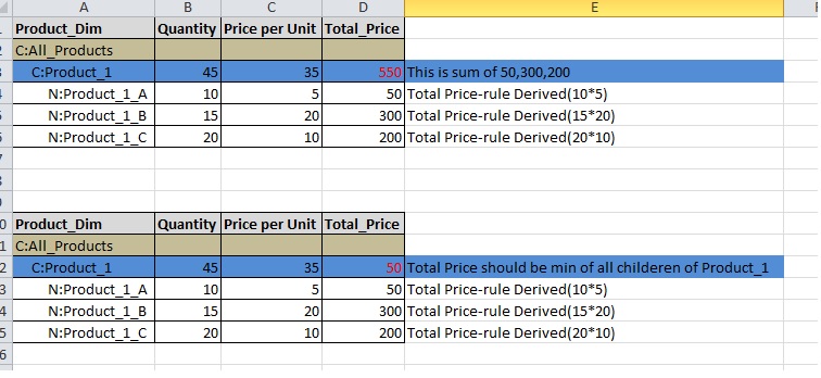

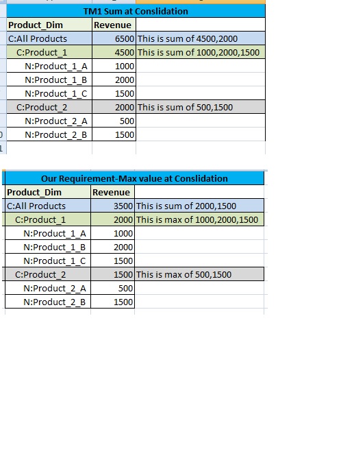

We trying to achieve to get the Max value at consolidation based on product elements instead of TM1 sum.
We have other dimensions as well in original cube.
Please find below sample screen for reference.
Any help/Suggestions are much appreciated.
Sathish
Sathish

Use ConsolidatedMax function e.g being...
['Revenue' ] = C: ConsolidatedMax(0,'Cube Name (or blank)',!Product_Dim,'Revenue');

Would there not need to be an identification of level for Product in this?
This code may produce a value at 'All Products' of 2000. With the requirement of All products to sum the components, this might not produce the right result at the top level, but will fix the issue at the initial consolidation level.

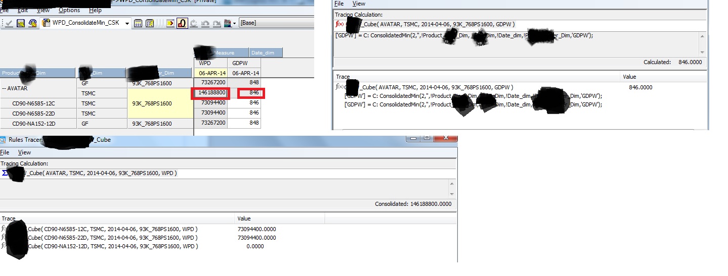

I am using "ConsolidatedMin" function to achieve the min value at consolidation,but it is not working for rule derived cells.
Please find attached screen shot for reference.
I tried with feeder also but no luck.
Is there any thing i am missed out.
Please help me on this.
Sathish
Sathish
- ConslidatedMin for Rule derived cells
- ConsolidatedMin for Rule derived cells.jpg (93.28 KiB) Viewed 12036 times

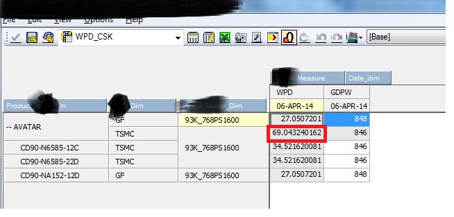

Please find below are my rules and attached screen shot.
I have two measures, one of which(WPD) rule derived and trying to achieve "ConsolidatedMin" at conslidation.
Other one i am loading through TI Process and using "ConsolidatedMin" , then its working fine.
Only Rule derived cells its not working.
Rules:
['WPD' ] = C: ConsolidatedMin(2,'',!Product__Dim, _Dim2,!Date_dim3,_Dim4,'WPD');
['GDPW' ] = C: ConsolidatedMin(2,'',!Product__Dim, _Dim2,!Date_dim3,_Dim4,'GDPW');
Sathish

If you want to apply ConsolidatedMax/ConsolidatedMin to all level 1 consolidation for the product_dim, you can use a rule like this:
['WPD' ] = C: If(Ellev('Product_Dim',!Product_Dim)=1,ConsolidatedMin(2,'',!Product__Dim, _Dim2,!Date_dim3,_Dim4,'WPD'),continue);
==> this would only apply consolidatedmin to level 1 consolidation of product_dim, and sum for other levels.
But instead of all level 1, you may want to an attribute to identify those consolidated elements that need to use consolidatedmin.

Please find below rules and cube trace calculation attached screen shot .
In the screen shot, the GDPW has loaded from TI Process and WPD has derived from rule.
Let me know if i am missing any thing.
