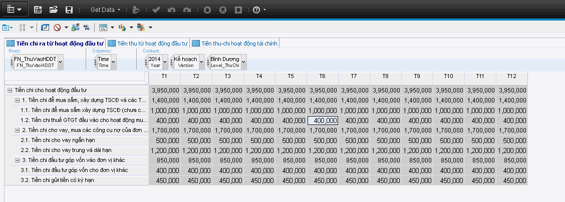

- I have application Approval, contain 4 cubes. I am input data on 2014 year. When I submit level, then data in all year lock.
I can't input data in 2015 year.
- I am want when i submit, data lock only in 2014 year. I try write rule in }cellsecurity_cube.

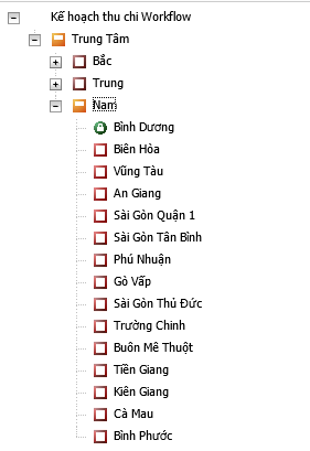

This is my structure approval.
I just wanted to intervene, lock only 2014 year and I can input data of 2015 year. And How to catch submit and reject the status of the cube ????

There is no way that you can submit 2014 in this application and leave 2015 open. Submission on a node (such as Binh Durong) will close ALL fields for this node.
