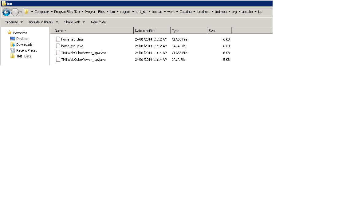

I uninstalled 10.2 then reinstalled it. After I reinstalled it I still got an error for Web but the bright side (I think) is that App Web now knows that performance Muddler is installed. I checked out what I think is the TM1 web Tomcat folder (C:\Program Files\ibm\cognos\tm1_64\tomcat\work\Catalina\localhost\tm1web) and it's empty. I don't think it should be empty. Any ideas what I can do about this? I spotted a folder called TM1Web.ga outside of the Tomcat and I was thinking I should copy the contents in. What do you think guys?
Jim.
Olivier
Posts: 159
Joined: Thu Jun 26, 2008 5:46 am
Version: Tm1 10.2.2fp4 -> 2.09
Excel Version: Excel 2013 - 2019
Location: Sydney
Re: 10.2 FP1 Not Opening TM1 Web
Post by Olivier »
Hi Jim,
Did you try to strat up TM1 application server ?
I am guessing some files might be generated form first service start ?
If that helps see below a screenshot of the Tm1Web folder content after FP1 install.
Tm1 Web folder content FP1.png (25.92 KiB) Viewed 15087 times
HTH,
Kind Regards,
HTH
Olivier

Thanks Oliver. I'm having to reinstall from scratch as my tinkering has stopped pretty much everything working. I had however already started the the application server and all my services after my last install run. I didn't however install FP1, The next install run I'll do both,
Jim.
