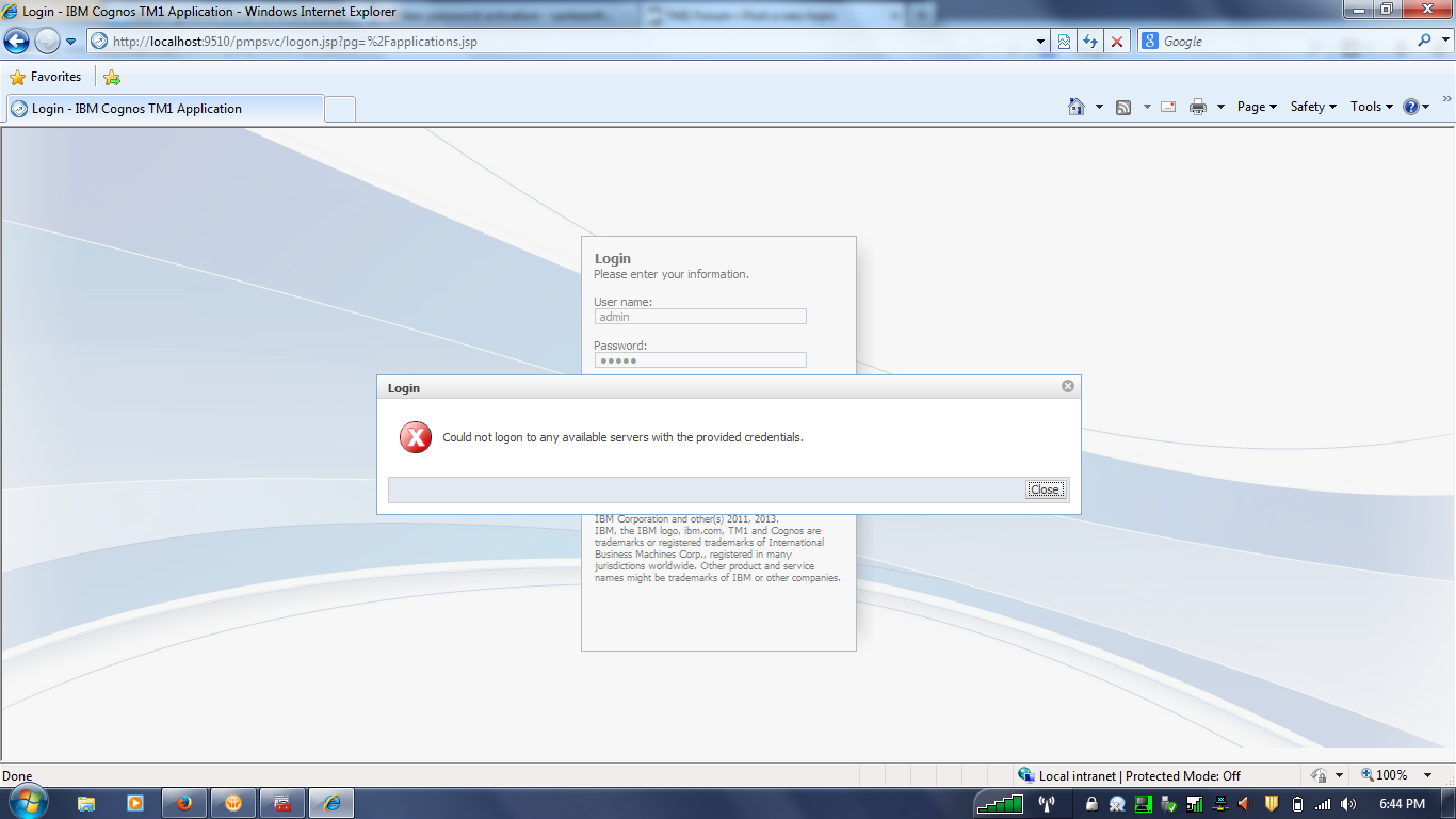

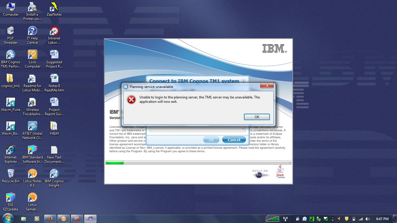

10.2 TM1 on single system installation is done with out any errors, and starting of the configuration is also done with out any errors.
but TM1 Application Web is not able to listen the request sent from the TM1 servers. and the same problem is with PM also.
Not able to use PM and Application WEB due to the same issue.
Architect, TM1 Web is working fine and able to log in to any available TM1 serves.
Kindly find the below screen shot for the same.
TM1 Application Web and PM is not able to connect to servers

But as to your actual issue; you need to add each service for use within the Applications portal before you will be able to access them and in order to access multiple ones at the same time you will need to have the same logon credentials for each service. I believe the portal in 10.2 changed to:
http://localhost:9510/pmpsvc/sysadmin.jsp
But that link is just from memory and may be wrong.
When you first log into the portal it should automatically take you to that screen and have requested a set up; what I tend to do is keep a couple of the IBM demo models such as SData installed so that you can start them up and definitely be able to log on with "Admin" and "Apple" which lets you get to the sysadmin screen in order to be able to add in your real services (those demos finally serve some use as anyone who would actually use one for a demo deserves to be banned from TM1 and maybe computing in general for life.
