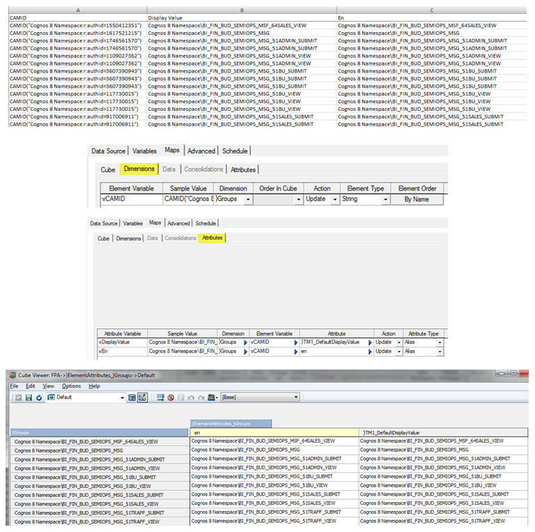

What I ended up doing is obtaining the CAMID's for all 870 security groups we have. This was a painful process as they aren't necessarily easy to obtain in a report (at least with the tools available to me). There is something called Cognos SDK or something like that, but no one here has worked with it. Also had a systems manager try various things but came up empty handed. So, with all that said, what I did is go to Cognos Connection and then click on Administer IBM Cognos Content, click on Security, my namespace name, and then drill down to the top security group. I then did a search on the group and when it found it, I went into Properties and then clicked on the link called 'View the search path, ID and URL' and that is where I found the CAMID.
I then created a spreadsheet that had the CAMID and then the associated security group name actually in two columns. Because then I created a process that would update the "Groups" dimension with the CAMID and then update the two alias' (Display Value and En).
This got all 870 into the security for my Tm1 server instance. From there, I was able to assign the various rights. Going forward, we don't add many security groups so I can just add via the server for the one off ones.
After the process runs, I then run the "refresh security" process.
By adding them this way, they did show up in my rights editor in PM for my Tm1 Application so it appears to be picking them up as a valid security group now that I've added as the appropriate CAMID. When I was adding them the other way with just the security group name, it was not picking them up in the rights editor in PM as they weren't valid.
But again, it appears to have worked. I am having to figure this out as I go and hope this is an okay way to do this. I'll attach some screenshots below so you can see the txt file (the screenshot is an excel file, but I saved it as txt) and then a couple of the tabs of the process and then the control object cube for Groups.
Group Security Update.jpg (243.66 KiB) Viewed 6408 times

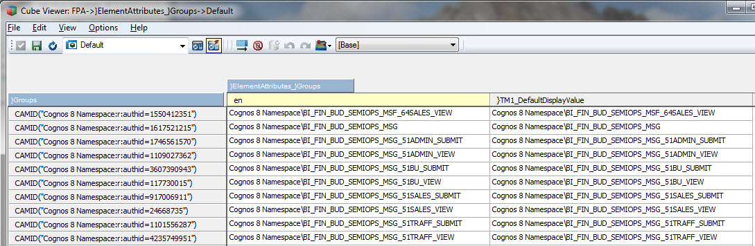

jimicron
Posts: 110
Version: 10.1.1
Excel Version: 2007 SP2 MSO
Location: Boise, ID
Re: BedrockTM1 Processes for Create Security Group
Post by jimicron »
Adding another screenshot with the Alias turned off in the Control cube, Groups. The other screenshot had it turned on.
Groups Security with Alias Turned off.jpg (249.37 KiB) Viewed 6407 times
