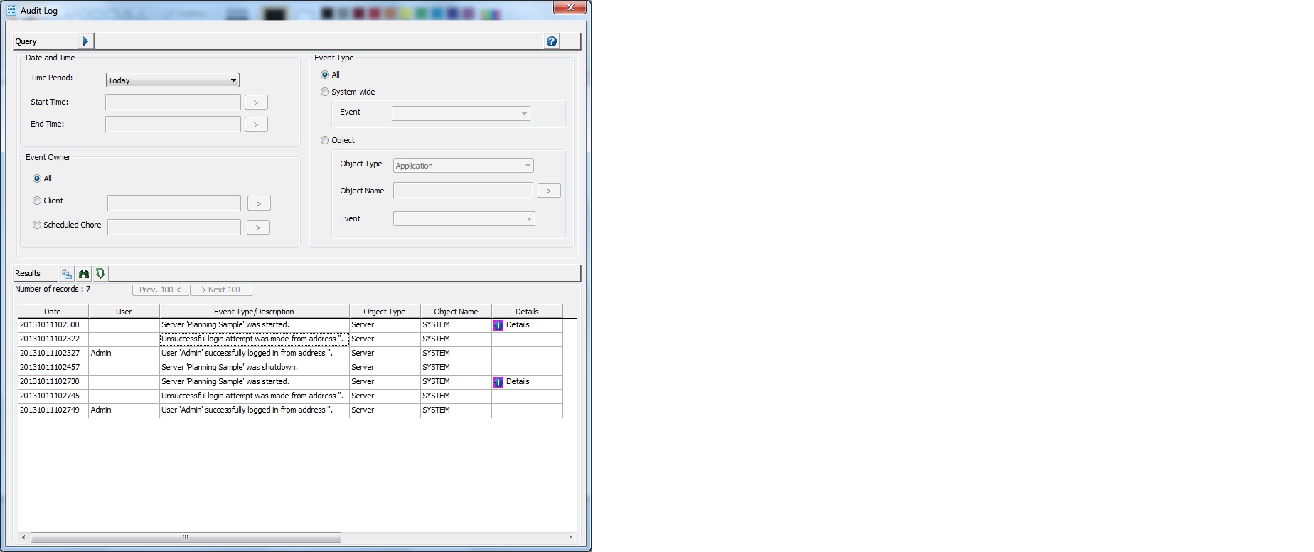

First make sure you have AuditLogon=T in the TM1S.CFG file. Then to view the audit logs you can look at the Audit Logs in the Server Explorer. This Audit log shows you the Successful and Unsuccessful logon attempts. See attached screen shot.
If you want to create automated Reports for Logon attempts, then you will have to load the TM1 Audit Store files into a cube. These audit logs are stored in files named tm1auditstore<datetime stamps>.LOG
Using TI you can first create a list of all the Audit Store.LOG files. In Windows you can use the '>' sign to list the files names to a file. Syntax is dir tm1auditstore*.log > AuditFiles.txt
See this URL for details: http://support.microsoft.com/kb/196158
Then use the AuditFiles.txt as the source of the another TI which will grab the file name and will parse through every file one by one. In the TI you can look for the Successful and Unsuccessful attempts. Successful attempt has the handler 144, while the unsuccessful handler is 145.
- TM1 Audit Logs
- tm1_auditLogs.jpg (159.1 KiB) Viewed 25308 times
