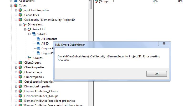

Hi Experts,
I am getting attached error while trying to open cell security cube.
Kindly suggest..
Error creating new view......
Tm1andTm1
- Capture.JPG (56.05 KiB) Viewed 5486 times

InvalidViewsSubsetArray suggests that a view contains an invalid subset of one or more dimensions...
ET

So did you create a cell security cube on an element security cube?
If I had done this I think I would have been surprised to see it work. Perhaps I am just a pessimist.

Applying element security on a dimension results in creating }ElementSecurity control cube with this dimension and with the }Groups dimension.
Applying cell security on a cube results in creating }CellSecurity control cube with all dimensions of that cube plus the }Groups dimension.
In your case you kind of "requested" a cube with two }Groups dimensions. TM1 does not allow using same dimension twice in a cube. If somebody from Iboglix would forsee such operation it should just result in some kind of an "creation error" message. I assume (at least in your TM1 version) that is not the case and TM1 somehow tried to create it but in a corrupted way.
If you try to create cell security cube on element security cube then I am assuming you do not understand correctly those security concepts.
I would say those are described well enough in documentation to learn from there.
