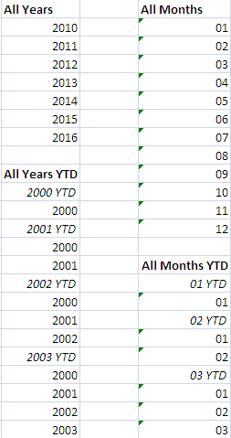

I have a scenario where YTDs is not fitting in the existing time dimension(Discrete), say in my existing system has YEAR and MONTH dimension separately like below,
Time Dim.PNG (9.5 KiB) Viewed 8214 times

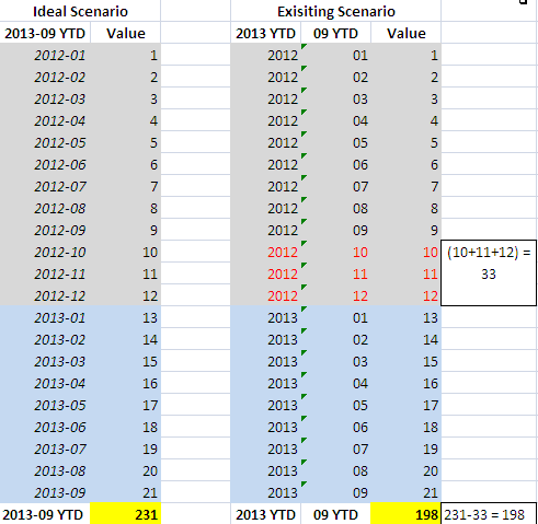

Now we got something to enhance by creating new cubes for cash flow, so only way is to stick with existing dimensions, in this above scenario, YTD is not possible for eg

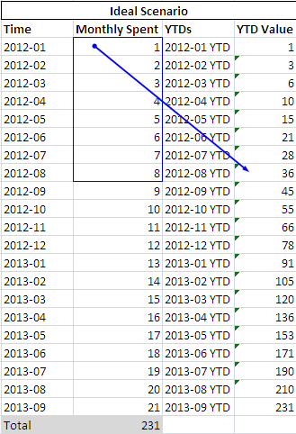

I can choose 2013 YTD and “All months” instead of 09 YTD, that gives me the right value, but in some places we need to use 2013-02 YTD, 2013-03 YTD etc., to do some calc for interest.

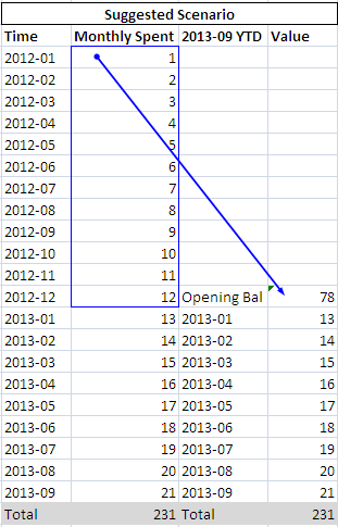

Just realised, one of my scenario will not fit in for creating "opening balance" in all months YTDs, say for example in below scenario. I have to get cost to date(CTD) spent on 2012-08 YTD for calculating some interest,
So If I use Opening balance it gives me the below but not the split of each month YTDs.
Suggested Scenario.PNG (13.7 KiB) Viewed 8074 times
I assume this is not possible, Any other suggestions please. In worst case scenario I'll try to do all YTDs in spreadsheet instead of cube.

You could create life-to-date consolidations (e.g. Mar LTD = OB, Jan, Feb and Mar) and year-to-date consolidations (e.g. Mar YTD = Jan, Feb, Mar). Then you can use whatever is appropriate for your report or calculation where you need to include/ exclude the opening balance. Doing any sort of consolidation in the spreadsheet is very sub-optimal.
