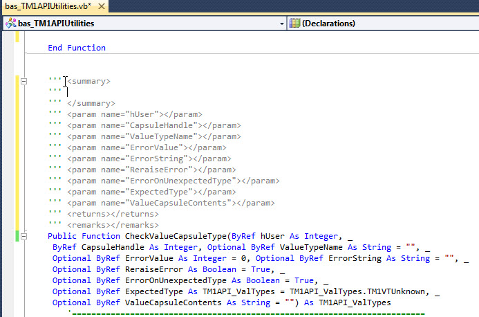

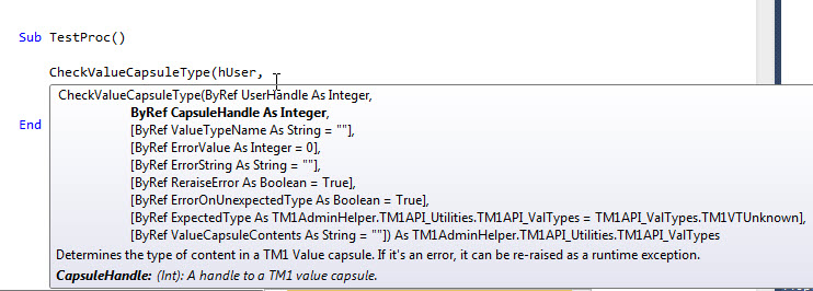

Another of my standard functions (the one which checks the data type of a returned value handle, actually) uses the TM1ValErrorString_VB function to extract any error string that may be embedded in the value capsule. As with TM1ValStringGet_VB, the API documentation claims that the argument that receives the value needs to be a fixed length string. Mind you, it looks like Iboglix just copied and pasted from the TM1ValStringGet_VBdocumentation into the TM1ValErrorString_VB documentation, as a result of which they nominate the wrong function. However the principle still applies:

XML Comments
Before we move on to connecting to the server, I want to mention something about commenting in VB.Net. You can of course still create conventional header blocks in your procedures, but you can also create XML comments.
I would have to say that I'm not generally a fan of XML. In a lot of cases it's just clouds of metadata bloat encasing a small amount of content which could more easily, and far more readably, be contained in plain text format. However it does have one big advantage here.
If you type three single quotes on the line immediately above a Module block, a procedure, or indeed a number of other code elements, an XML template will appear. (The nodes are the default ones, but you can customise them by adding additional ones.)
In the case of a procedure, you get nodes for a summary of the procedure, for each of the parameters / arguments that you pass to it, for the return value, and for any remarks that you have. When you fill in the nodes, then when you call the procedure you will have a rich Intellisense prompt that gives you the details of the procedure and its arguments, the summary of it, and as you move from one argument to another the description that you've added of what the argument is for right at the bottom.
Obviously this feature becomes exponentially more useful as your project becomes larger and the number of people who work on it increases.
It's as useless as chicken dung on a pump handle for producing human-friendly documentation in any kind of help file format, though, at least without some kind of external utility to lend it a hand.
