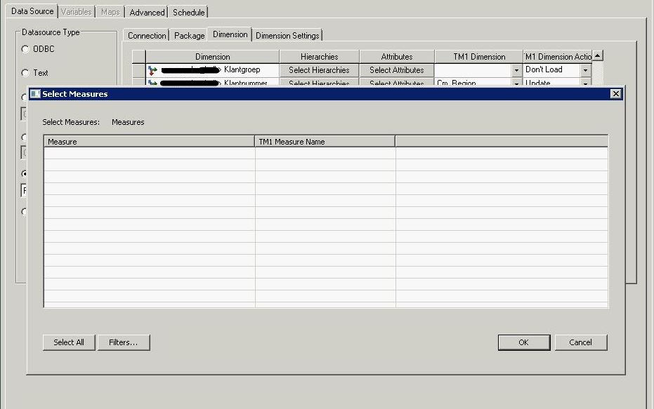

I am trying to load data from a Cognos package (a cube in Powerplay) into a TM1 cube.
I have installed the TM1 Package connector and it works!
I can import all dimensions, but only the measures cannot be selected: if I click on "Select Measures", I get an empty list.
As I cannot select any measure, I have no data at all in my cube :-(

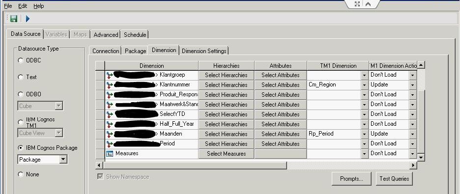

Does anyone have advice on this one? I verified that the measures exist (there should be 6 measures in the Measures dimension), using Powerplay. I add 2 pictures on the TM1 part.
Thanks in advance!
I cannot see/select any measure !

Picture 2.JPG (75.88 KiB) Viewed 10105 times
The dimensions are fine, I can select hierarchies, attributes, and so on

At this time the only OLAP source we permit you to extract fact data from is SAP BW. There is special support for efficient extraction from SAP BW.
The Cognos BI compatible mode query stack does not have good support for null suppression for a variety of sources.
This leads to almost certain failure when extracting facts from PowerCubes or other OLAP sources (either out of memory or waiting forever for the query to complete).
Note: Transformer imposes the same restriction....
You can emit CSV files from Transformer during cube builds for your queries and use that as input to TM1 as an option.

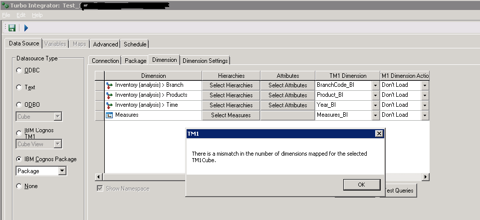

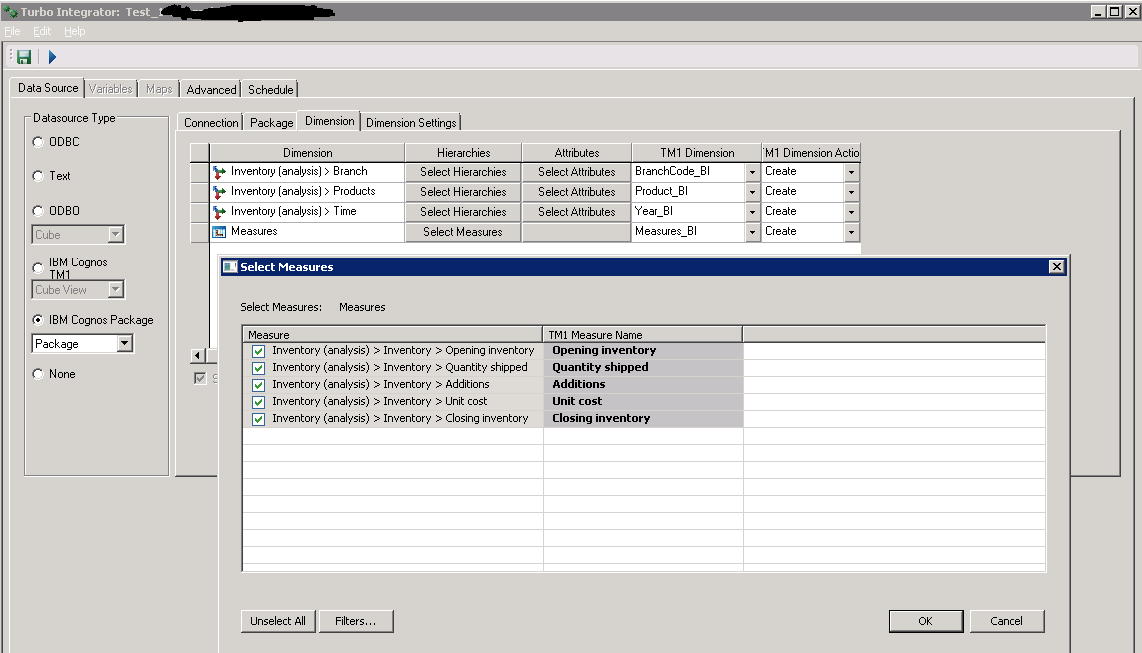

I was trying to do something similar - Loading Data from a Cognos Package into a TM1 Cube.
But to my surprise, I was able to select the measures and everything was correctly placed.
But Again... :roll: I was NOT ABLE to select another dimension as a Measure Dimension to which the data should load into.
This screenshot shows that the measures can be selected.
But we need to add another dimension as 'Measure' dimension to which the data should get loaded. Am I right here?
And the Package Connector does not allow to add a new dimension, like the way we add in the Variables tab (when loading from a csv or ODBC) when a dimension count is less.
Any suggestions or help appreciated here.
