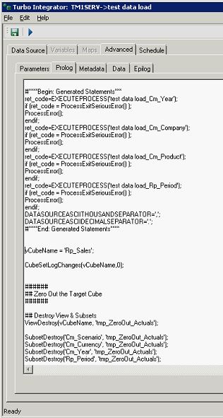

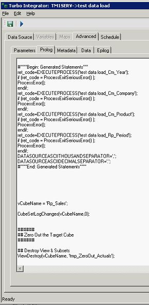

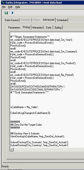

Re: TI Editorsaurus Generating Incorrect CELLPUTN function
Another strange issue with the Editorsaurus, it happens when connecting to a Cognos package using the connector:
See the different attachments below, right below the "Generated statements" area.
The ONLY thing I do, is saving. Upon each save, 2 lines of whitespace are added
- 1.JPG (50.87 KiB) Viewed 6234 times
- 2.JPG (47.56 KiB) Viewed 6234 times
- 3.JPG (45.74 KiB) Viewed 6234 times
