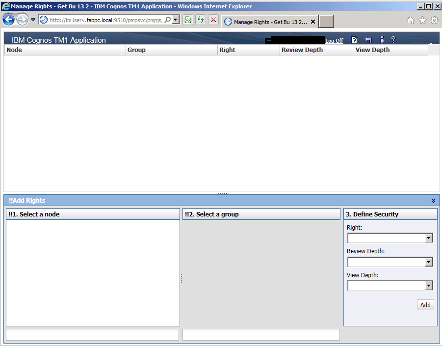

I am new to TM1 and with my brand new 10.1.1 TM1, I try to manage the rights of a dummy application called "Get Bu 13 2". The application is of type "Responsability" and validates fine. It is now deployed and when I am in "My applications" web front-end, I can see it. But when I click on "Manage rights for ...." , I get a windows with no node and no rights. Has anybody anybody an idea of why it is so? I would like to define rights for each node!

- Showing my "manage rights" window.
- no nodes image.png (32.6 KiB) Viewed 3072 times

I found a possible workaround to this problem:
Actually, the problem happened with IE9. I tested the application with Firefox and surprisingly it worked.
Now I can say that the application "Manage rights" does not work with IE 9 or IE 10, but works fine with Firefox.
I haven't tried to look for the root cause.

If it ain't an issue, can you post some sample group names as well as node names from your environment? I am interested to see if there is a special character in any of them.
