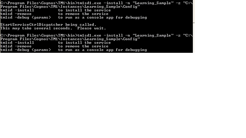

Hello Friends,
I am facing an issue with installing an Instance as a service. I am using a Windows 7 Machine and installed Windows XP mode over it to work with a TM1 9.5
Now when I am trying to create a service for this instance, it is not giving any error, but not creating the instance as well.
It keeps saying "StartServiceCtrDispatcher" being called, but does not create the service.
Plz see the below screenshot.
Service Install Issue.jpg (60.36 KiB) Viewed 15462 times
Please advise me on the issue
Suharsh....
Re: TM1 as a service
If you are installing anything on Windows 7 you have to run the install program as an Admin. In this case, you have to open the CMD windows as Admin and then key in the commands.
Post by Suharsh »
The CMD is running on Windows XP. As I said I have installed a virtual machine (Virtual PC XP Mode) on my windows 7 machine, from the below link
http://www.microsoft.com/windows/virtua ... nload.aspx
So I guess in XP it not required to run as administrator.
Suharsh....
Suharsh wrote:Has anybody got any suggestions to offer on the above mentiones issue......
Just that if you have Win 7 Ultimate I wouldn't even bother with XP mode. Although not a supported environment (but then neither is XP...) I've had no problems running 9.5.x servers directly on it as long as they're installed on an Admin account.
Post by Suharsh »
Thanks for the informatin Alan. But I think I should try reinstalling the XP Mode onto my Win7 machine as it is not working out for me (may be because of compatibility issues). I have though successfully installed this version of TM1 onto Win XP (When I was using XP Earlier), but not sure why this issue came up in the XP Virtual Machine, as the Virtualization concept itself tells that the Virtual machine layers will be Abstacted from base machine.
Lets see, I will update if I find anything intersting this time.....
Let me know if anyone has any inputs
