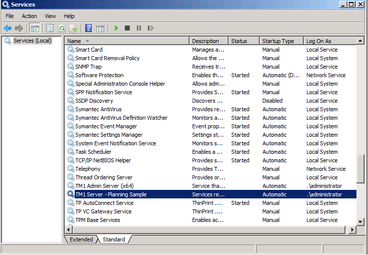

See the attached screenshot. The column on the right shows the windows user which must have the correct permissions to run the bat file.
The TM1 user is irrelevant as all interaction between Windows and TM1 is done under the windows user set in the services console.
- services screenshot
- services.png (52.68 KiB) Viewed 9550 times
