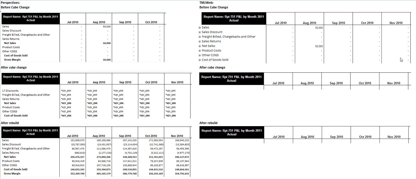

Hey guys, I'm experimenting with a single active form which can be rebuilt based on a cube selection. The form works beautifully in perspectives (user selects cube, recalcs to get proper dimension values, then rebuilds to get the new cube values). My problem now is that the form won't work on TM1Web. From what I can see, the reason for this is that after changing the cube selection, the row containing the TM1RPTROW goes blank until you rebuild the form. For whatever reason, TM1Web can't handle the rebuild.
I've tried the following workarounds to no avail:
1. An IF statement in the TM1RptRow: =IF(CUBE="Finance JDE",TM1RPTROW($B$12,SERVER&":jde_account","Standard PL",,,,,0,),TM1RPTROW($B$12,SERVER&":sap_func_account","Standard PL",,,,,0,))
2. An IF statement in a 2nd column (the DBRW ref, to keep that 1st row from going blank): =IF(DBRA(SERVER&":"&ACCTDIM,B28,"description")=" ","Sales", DBRA(SERVER&":"&ACCTDIM,B28,"description"))
3. A separate tab which passes the cube selection to the active form named range CUBE using the advanced properties on an action button (this opens a new version of the app in perspectives but just switches tabs on TM1Web).
Any thoughts on getting that TM1RptRow to stay active? A couple notes:
1. The cube's dims are in the same order, and for two of the dims I have a named range making a substitution based on the cube name. For example "ACCTDIM" changes from jde_account to sap_account based on the selection. This ACCTDIM is referenced in the TM1RptRow function.
2. I have a separate TM1RptView statement for each cube, and the cell the DBRWs refer to is =IF(CUBE="Finance JDE",B10,B11)
3. The TM1RptRow refers to a subset "StandardPL" which exists on both rowset dimensions.
4. Autorecalc is on.
Again, this all works fine in perspectives, it's just that "break" of the TM1RptRow function which causes the issue on the web. It will render regardless of which cube I start with, but when I change cubes it won't render.
Screen shot attached. Thanks in advance!

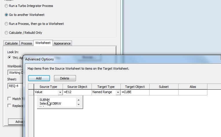

That said, I did try both of those options, to no avail. When I upload the report with a blank cube selection, it will still only render for one cube selection. Somehow, it's holding the value of whichever cube was last successfully rendered on the web (if I upload the sheet with SAP selected, then upload with a blank selection it will only render SAP and vice versa). I've closed all browser windows, uploaded a completely different file, and changed the cube selection from a SUBNM to a dropdown. Still nothing.
As well, I did try sending the cube value to my named "CUBE" cell using the advanced options and it didn't work either. I get no value in the CUBE cell. See the attached screen shot for the options I selected, maybe I did something wrong. This is true whether I use a SUBNM or a Value as my source, I still don't get any result in the target cell.

Quick update, I was able to get the value to pass over (I needed to remove the "=" from the target object cell in the advanced options for the action button). Unfortunately, now I'm still getting the same result: it will only render the cube which was last successfully rendered on the web.
