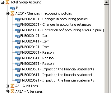

Im having some difficulties making Many 2 Many relationsship work in TM1. The trouble is that it sums up the total of the many2many dimensions. This works in Framework Manager, which is my source in TM1, but when the data is summed up to the total its wrong. I know its working as intended and i have to "break" the sum up with a rule but im not getting that rule working. The rule states that if we are at the top of one the M2M dimension we should add the sum of a dimension. This is kind of hard to explain...
Ive added a picture from framework manager on how the tabels relations are set up.
Any tips or suggestions would be greatly appreciated.
/Peter
Many to Many tables
Many to Many tables

It's "kind of hard to explain" yet you offer no attempt at trying to explain it except for a worthless diagram? Where in TM1 is this? A TI process, a dimension structure, or a cube rule? You say the rule works as intended and then you say it doesn't work? Which one is it? You need to provide some details here before anyone is going to be able to provide assistance. Granted it may be difficult for you to do this but why should we have to guess at to what your problem is. Give us specifics as to what you have done in TM1 and exactly what is not working.

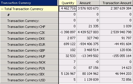

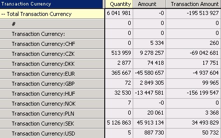

The TI process arent that exciting since im using a DMR from framework manager as source. Its been modeled as star schema except the Many to Many tables depicted in the "worthless" diagram above ;) .
Hopefully the pictures should explain this better.
I was hoping of using a rule sort of like this
SKIPCHECK;
IF(DTYPE('Group Account',!Group Account) @='C',
# Add values
# Add Total from cueb without M2M dimension
FEEDERS;
Let me know if you need more info.
Br
Peter
The values when adding the M2M dimension in the cube
Incorrect values.jpg (59.24 KiB) Viewed 3439 times

Correct values when cube loaded without the M2M dimension
correct values.jpg (55.89 KiB) Viewed 3439 times
Re: Many to Many In TM1 or Framework manager
