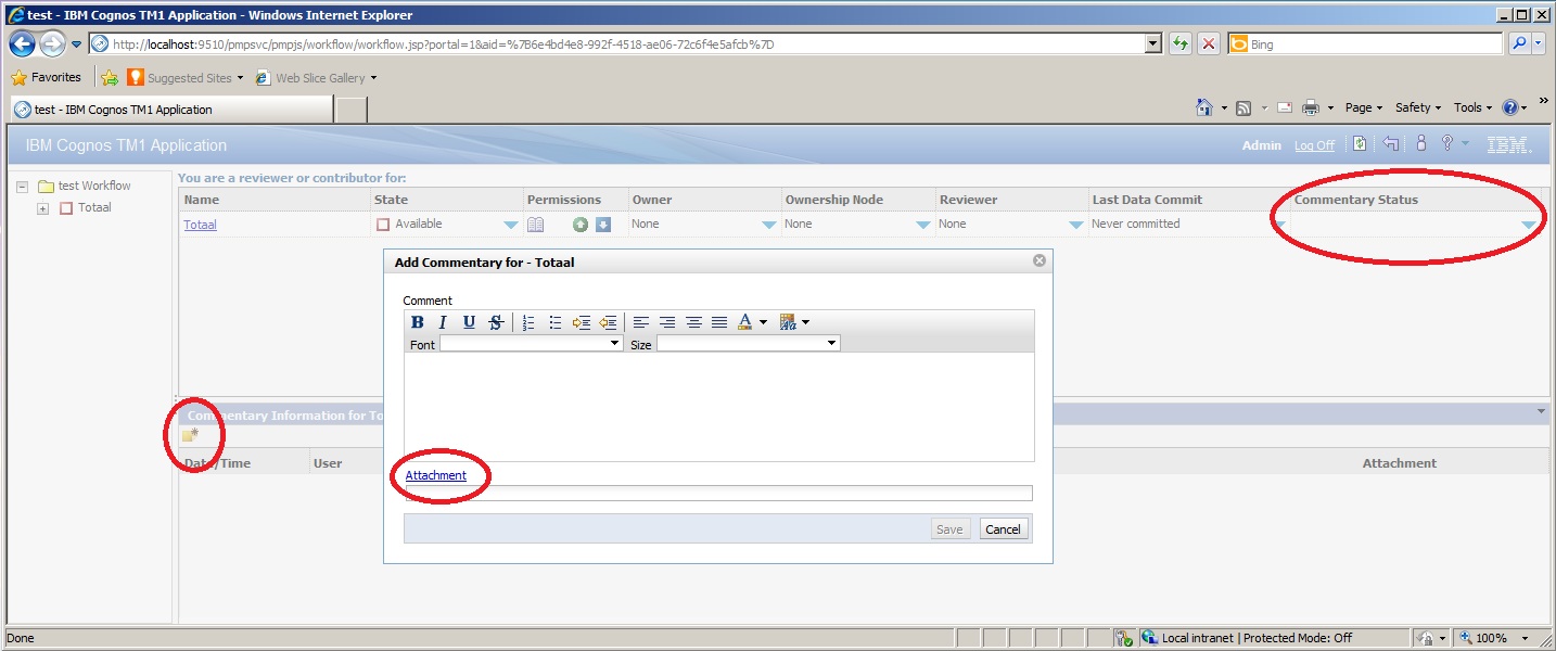

- Andy
- Posts: 15
- Joined: Fri Oct 12, 2012 1:38 pm
- Version: 2.05
Re: 10.1 Adding Help Docs to the TM1 Application
Hi Mark,
I attached a printscreen where you can see that you have the possobility to attach documents in TM1 10.1.1 built with the Performance Modeler.
Andy
Andy
- Attach Documents
- Attach Documents.jpg (166.76 KiB) Viewed 13879 times
Mark H
- Posts: 60
- Joined: Tue Jul 10, 2012 3:37 pm
- Version: 10.1
Two things to say:
1. I'm not really on 10.1.1
2. that is really stupid place to add comments. I was ading comments onthe cell to explain that cell or that cube. Not expecting to attach series of explanatory files to the node after i have completed the forecast. Perhaps 10.1.1 also allows attachments on the cell.
Thank you. This very important functionality. And I can not find any mention of it in release notes.
Cheers
MH
