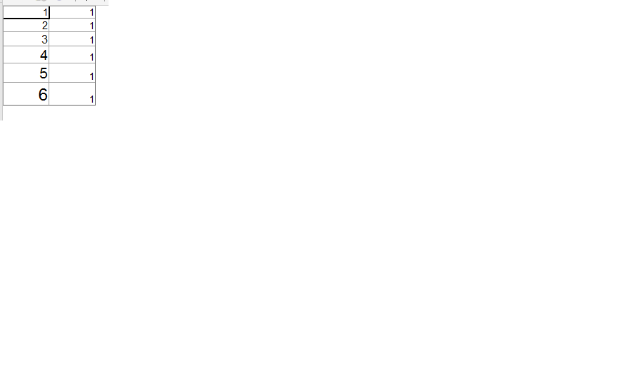

lotsaram ... that's brilliant.
So the row height follows the largest font in the line.
I don't even need the attribute lookup in most cases (but that's a good idea too).
Just a conditional format on a hidden column that sets the font size based on level.
I'm going to start using that.
- Spacing.png (9.44 KiB) Viewed 15353 times
