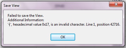

Hi Good Guys :D ,
I have another problem. Whenever I save a particular view in EV, this error always appears. See attached files.
I can't find answer in Google.
Please if someone understands this error.
Many thanks. :D
Bunchukokoy

This is a weird error.
Have you tried changing the Title Elements in your view? May be there is an element which is an invalid character for the EV Data source table.
Cheers!

Post by bunchukokoy »
Does this somehow indicate some invalid characters that IE cannot render?, because some of my item descriptions in TM1 have non-alphanumeric chars.
What is EV Data source table btw?
Thanks so much. :)
But my data source table has always been TM1. I haven't used other source table. This one I posted is TM1. When I look at pages regarding 'hexadecimal value...' error, there's this XML thing they say, but I am not in-depth with XML technically. I'm just hearing the name. Do you have an idea about this error being related to XML?

bunchukokoy wrote:But my data source table has always been TM1. I haven't used other source table. This one I posted is TM1. When I look at pages regarding 'hexadecimal value...' error, there's this XML thing they say, but I am not in-depth with XML technically. I'm just hearing the name. Do you have an idea about this error being related to XML?
