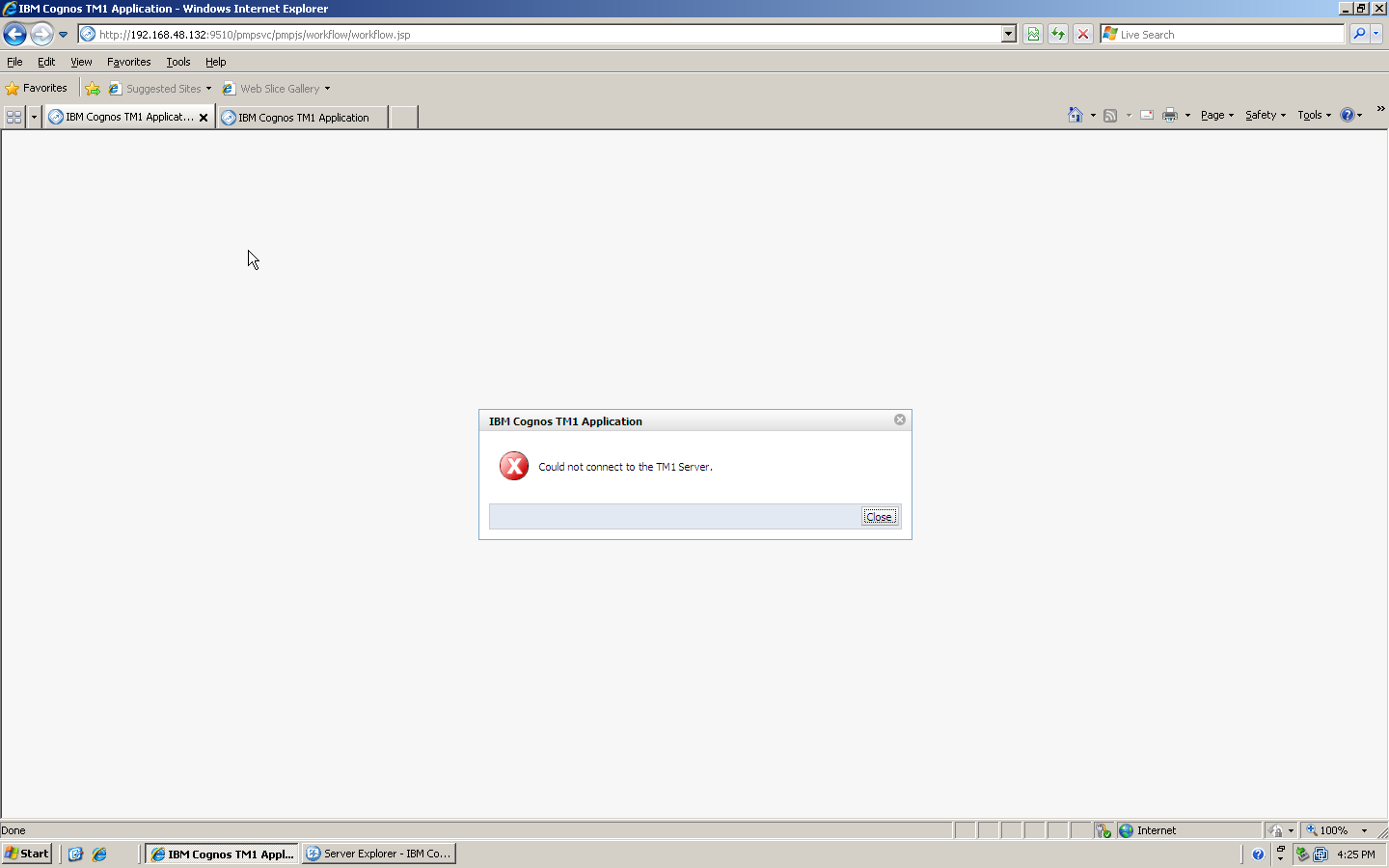

Just wondering...if anybody encountered this problem before. I'm trying to log into the TM1 Contributor Application as a user but every time I log in I get this error.
I know its how I set the CAM security that's causing the problem but I'm not sure what. I have no problem logging in the Server Explorer...so I'm not quite sure where BI is having a problem connecting with the TM1 Server.
This is TM1 10.1 with IBM Cognos BI 10.1.1
IBM Cognos TM1 Application:Could not connect to TM1 Server
- IBM Cognos Business Intelligence 10.1 & IBM Cognos TM 10.1 Demo VMWare-2012-05-18-16-25-08.png (39.93 KiB) Viewed 8290 times

Can you log into the TM1 Contributor Application as a TM1 user being a member of the TM1 User Group Admin or Data Admin ?appleglaze28 wrote:Just wondering...if anybody encountered this problem before. I'm trying to log into the TM1 Contributor Application as a user but every time I log in I get this error.
But when you log into the TM1 Contributor Application as a TM1 user NOT being a member of the TM1 User Group Admin or Data Admin, then you got the error message ?
After you got the error message:
Could not connect to the TM1 Server
check the TM1 Contributor logfile pmpsvc.log for an error message looking like:
ERROR (listApplications) com.ibm.cognos.pmpsvc.session.PMPSVCSession - An exception occurred while initializing TM1 session
Is there such an error message whose timestamp matches the time you got the error message "Could not connect to the TM1 Server" when you tried to access the application ?
If there is such an error message in your TM1 Application Web logfile pmpsvc.log then:
- Stop&Restart the TM1 Contributor (Windows) Service.
- Logon as a TM1 user being a member of either the TM1 ADMIN group or TM1 Data Admin group.
- Open the application rights page and save application rights.
