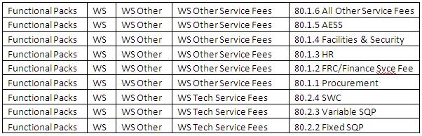

This is a dimension hierarchy which i tried to load through a TI and the elements in the hirearchy looks as below
The last column is not getting loaded into the dimension structure because of the numbers I believe.

anoops81 wrote:Hi Matt ,
Functional Packs WS WS Other WS Other Service Fees 80.1.6 All Other Service Fees
Functional Packs WS WS Other WS Other Service Fees 80.1.5 AESS
Functional Packs WS WS Other WS Other Service Fees 80.1.4 Facilities & Security
Functional Packs WS WS Other WS Other Service Fees 80.1.3 HR
Functional Packs WS WS Other WS Other Service Fees 80.1.2 FRC/Finance Svce Fee
Functional Packs WS WS Other WS Other Service Fees 80.1.1 Procurement
Functional Packs WS WS Other WS Tech Service Fees 80.2.4 SWC
Functional Packs WS WS Other WS Tech Service Fees 80.2.3 Variable SQP
Functional Packs WS WS Other WS Tech Service Fees 80.2.2 Fixed SQP
Anoop
I don't think it's to do with the numbers. As much as I avoid "special" characters in element names, something like "80.1.6 All Other" should be a perfectly acceptable.
Are any elements from that last column getting added at all? How is your file delimited? You could perhaps post the code from the metadata tab of your process too.

Hi Alex,
No element with number & string together is getting loaded.
