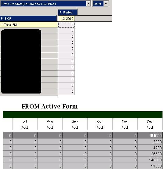

I have a issue with data showing in cube (architect ) and same intersection in Active form both are not same. Behaving like active form is caching data. I restarted server but no luck.Even i double checked the DBRW formula to see which intersection the cell is referring . For same intersection the cube calculated value is 0 and the Active form in TM1 Web and Perspectives showing 2000$ ....same way for many products for a particular month.
Check feeders does not show any 'Not Fed' status too. They are fed properly.
Let me know if needed any more information.
Appreciate your help. Thank you
Values in TM1 Web and architect cube are different

I haven't come across an issue with an active form caching or showing incorrect numbers. I'm sure we would have heard from other forum members if it was a known bug.vinnusea wrote:I have a issue with data showing in cube (architect ) and same intersection in Active form both are not same.
If your values are rule-calculated, check the feeders. Consolidated values will show as zero if they are consolidating unfed calculations.
Otherwise, I would suggest checking from the basics up. Is your Admin Host correct, do the forumulas point to the correct server name, is the cube name correct? F9 all the DBRW values to ensure they are the intersection you intend, etc.
The screenshot you attached doesn't look like an active form. How did it know to call your period column "Dec" when the element is "12-2012"?
If it's just a regular Excel spreadsheet as opposed to an active form, then you've just gotta check and double check. You can safely assume TM1 won't show an incorrect value.
It's hard to help beyond that without having access to the spreadsheet and server.

Your cube view says "Prath standard (Variance to live Plan)". Your active form says "Fcst". Those two don't sound like the same thing to me.
If they are the same can you try showing a complete screenshot, showing the entire cube including server and cube name. If you need to, check with your manager about not blanking things out, as it can make the issue much harder to diagnose. For the active form part can you run a trace on it (e.g. with this tool) and include that in the screenshot. The more info you can include the better.

Yes , It is not caching . Active form is created from the same cube view but in excel i have done lot of calculations and also converted period structure to show month names and a lot of stuff. Some how excel formula got disturbed and only December pulled data from different year.Sorry for posting.
