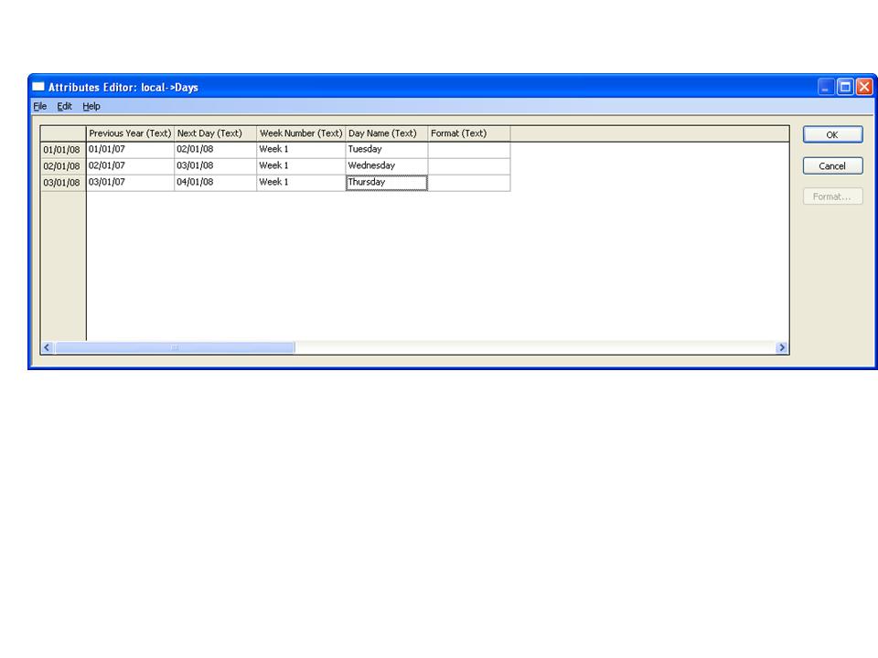

Robert,
One way of adding weeknum functionality is to use dimension attributes. Create a Time or Days dimension with the days of the year in, add new attributes (Text) (Right Click Dimension, Edit attributes, File Add New) of 'Day Name', 'Week Number', it's not uncommom to also have 'Next Day', 'Previous Day', 'Previous Year', and so on. It might seem like a long and labourious task but it is a one off, you can reuse the dimension and it doesn't have to be in any cube at all and can just be used for reference. Also you can create the text for the attribues in Excel and then copy them in, making numbering a little easier.
Within TI you'll need to use, ATTRN for numerics and ATTRS for strings to retrieve the attribute.
Just a couple of other things, although I suspect you haven't posted your entire metadata tab,
1. You need to set nCounter initially
2. You need to set nStop initially
HTH
Neil
HTH
Neil
