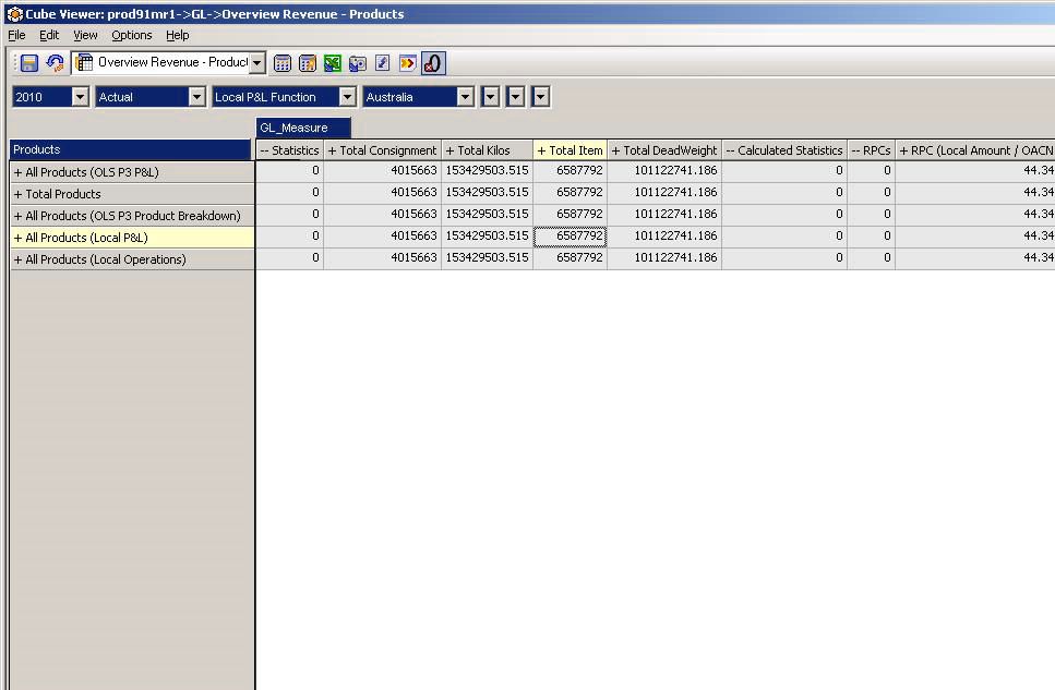

Few monthes ago, i tryed a base 9.4 version install and migrated our production model hosted in 9.1sp3 ( just a copy ).
The installation was done without any issue.
The server started just fine and so far everything looked good.
When started exploring the cubes/views in this new 9.4 environment , i quickly noticed 2 major issues :
1 - some of the title selections were changed compaired to the original view settings
(i. a high level ebit monitor view suddently display total cost as account selection while the view was saved with EBIT selected)
2 - In certain views ( not all of them and not for the same dimensions), some title dimensions were not showing the active selection giving the impression that nothing is selected.
Note : if the view is sliced, then the title field would be showing correctly in the excel spreadsheet.
I have attached a screenshot of what the view looks like with 3 of the title fields impacted. (the last 3 title fields.)
I believed at the time that it was one of the reason that MR1 was made
and stopped the testing phase to plan another one using MR1 and the 3 Fix Packs.
We have started to test 9.4mr1 including FP1, 2 and 3 and unfortunatly it reproduces these inconsistent views bugs.
This is definetly a no go for using this in production.
My assumption is that it can be a side effect of a "conversion" from a Datafolder from 9.1sp3 to 9.4mr1...
Which would mean upgrading mean recreating all the cubes and the rest from scratch in the new environment ? (the risquiest upgrade ever).
Did anybody encounter a similar type of bug when upgrading an old TM1 database from 9.1sp3 or older to 9.4, 9.4mr1 or 9.5version ?
Our server OS is Window server 2003 and Perspective is run through Excel 2003.

- View Bug - 9.4mr1 SP3.jpg (69.37 KiB) Viewed 324526 times

From Revelwood:
"This is some type of fingerprint software that came pre-installed in all of our Dells.
To troubleshoot, in case anyone else has the issue caused by other conflicting software, I booted in Safe Mode, then noticed problem went away.
Then I went to msconfig, turned off all startups, and narrowed it down to the conflicting software
Hope this information helps and big thanks to Revelwood for debugging this one.
While working with Partner Revelwood yesterday we had them run a series of test where they had a Tm1 (x64 bit) server running on their Dell laptop which was running Win7 x64.
1. Connected to my server from another box (W7 x64) – No cube viewer issues
2. Connected to my server from another box (W7 x86) – No cube viewer issues
3. Connected to my server from another box (XP) – No cube viewer issues
4. Ran server on another box (W7 x64) – Connected to that server from my laptop – Same cube viewer header issues
5. Ran server on another box (W7 x86) – Connected to that server from my laptop – Same cube viewer header issues
6. Ran server on another box (XP) – Connected to that server from my laptop – Same cube viewer header issues
Now what Revelwood found was if they run in safe mode and re-ran steps 4, 5 and 6 as well as running both client and server on their same laptop - the problem went away.
After further investigation there seems to be some "bloatware" installed on the laptops called DigitalPersona Pro.
From Revelwood:
Re: Missing title elements in a view, TM1 9.5 and up
Hi there
I followed the useful information above, and pinpointed the problem with a startup item called "nwiz" (nwiz.exe).
I disabled it in msconfig and now the title elements show up nicely.
Thanks for the guidance, much appreciated.
Wim
Wim
thomaskday
- Posts: 8
- Joined: Mon Apr 26, 2010 2:38 am
- OLAP Product: TM1 / Planning Analytics Local
- Version: PA2 Local 2.0910, PAW 2.074
- Excel Version: 2016 and 365
Wim,
I came across a similar experience when using HP laptops. It appears that some of the pre-installed HP utilities casused a similar issue. Problem was the HP Protectection tools (HP Protect and HP manager) that were causing the loss of title elements. Remove them and TM1 is happy.
Cheers
Thomas
Cheers
Thomas
- BigDSter
- Posts: 55
- Joined: Thu May 15, 2008 8:02 am
- Version: 9.4.1
- Location: Preston
Just had the same problem on a Windows 7 64bit laptop
Tried
Office 2010 32bit with 9.5.1 - Missing title dimensions
Office 2010 32bit with 9.4.1 - Still some missing
Office 2007 32bit with 9.5.1 - Missing
Office 2007 32bit with 9.4.1 - Still missing
So in a bit of inspiration our ops guys disabled running apps one at a time until it worked, seemed it was down to some single sign in software we use called imprivata.
Close that and it worked fine, thankfully, as this was our test user for a new Win 7 64bit Office 2010 rollout.
Tried
David Newton
Burtons Foods
Burtons Foods
- Posts: 6672
I had this one just tonight (9.5.2). It wasn't happening on all views on all cubes but I once it started happening I could reproduce it on the same cubes repeatedly.
- Did a search and found this thread.
- Deleted .exd files - Did nothing.
- Deleted .ini file - Did nothing.
- Deleted contents of Temp folder - Did nothing.
- Found this link on IBM's site which was... not entirely helpful, given that this is clearly happening on machines which have never had "DigitalPersona Pro" anywhere near them, and which were NOT necessarily Dell or HP. (Mine was neither, and indeed I do not deal with Dell, a company which I consider to be parasitic scum, in any way that doesn't involve needles and voodoo dolls.)
- Reinstalled base client.
- Reinstalled FP1.
- Problem no longer occurred.
Which brings me to the reason that I don't consider the Support document to be that helpful. I did not disable any startup programs. I did not uninstall any software other than the TM1 client. Does it not seem reasonable to assume that this is, in fact, something that is going wrong in the client? For if it was truly and always an issue with the client interacting with other software... all of that software is still there, and you would expect that the interaction problem would persist.
- Reinstalled FP1.
