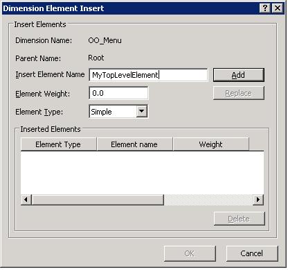

For what it's worth, if you add in an element into the Dimension Editor with no parent (i.e. top level) then the little dialog box calls the parent "Root"

jim wood
Posts: 3964
Version: PA 2.0.7

Post by jim wood »
Will it though? By putting Root in parent it is actually suggesting it has no parent as it is a root object. This a dialogue box for adding elements. If you insert a child to this it will say the element you first created as a parent. How ever if you select add element instead of insert child the parent will say root. You could argue it's right in both cases. When an element has no parent and is level 0. If it has no parent and is level 6 it is still root, therefore root is neither level 0 or level6, it is any element that has no parent. If we are holding with this definition that is.
