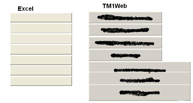

I am having issue with the size of Action Button. Some of the Action buttons are appearing bigger in TM1Web. See the attached image for details:
Active Form Size issue in TM1Web
At least half of the buttons are not appearing correctly. I have also tried to set them with a fixed size in the Developers Tab -> Format Object -> Size and Rotate but still no gain.
Did someone else had the same issue before? How can I fix it?

we had similar issues in 951 and were referred to this;
https://www-304.ibm.com/support/docview ... wg1PM11884
which suggests that the issue is fixed in 952.
I've just done a test in 952 (no hotfixes) & I see that the issue is now worse - buttons display incorrectly even on the inital rendering as you have found also.
We ended up converting all our Action Buttons to Hyperlinks which I think actually looks better in a browser.
So it seems IBM have not yet fixed the issue - unless it's fixed in a 952 hotfix.

We once had the same issue in 9.5.2.
Changing the file type from *.XLSA to *.XLS solved the problem
