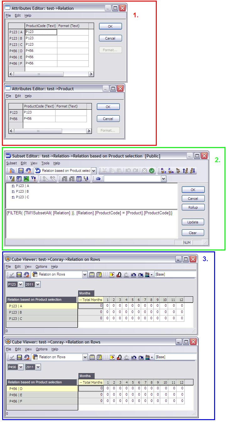

Found some time to try to achieve what (I think) you need. The solution that worked for me is very similar to the case lotsaram gave you a link to, just requires a small trick with attributes you don't have but can easily create.conray wrote:i did see that topic before i posted but i am still unsure how does the expression actually works.
Here is the step by step instruction and below you have corresponding picture:
1. Create ProductCode text attribute for both dimensions and fill it with values like on the picture. I did it manually, but you can also do it e.g. via rules (if the algorithm is as simple as in your example).
2. Create a subset for the Relation dimension ({FILTER( {TM1SubsetAll( [Relation] )}, [Relation].[ProductCode] = [Product].[ProductCode])}).
3. Create a cube and attach the created in step 2. Relation subset either to rows or columns while your Product remains as title dimension. Switch between elements in Product dimension and recalculate to see the result.
HTH

Hi jstrygner,
That is exactly what i required!
Thanks so much for the advice.
