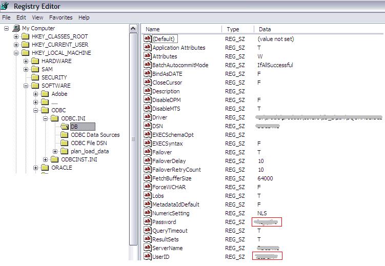

The name of the ODBC connection - I agree that the best way is to put it in a cube (or attribute that in fact also is a cube).
I once had an issue, when TM1 administrators were not supposed to see user id and password for the ODBC (if you'd store those in TM1, they would).
It was a windows, so in this case we used regedit and stored password and ID in here (attachment) and in TI you left user id and password blank.
- 20110706 - ODBC - id and psswd.JPG (63.58 KiB) Viewed 22240 times
