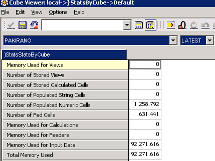

I have turned on TM1 Performance Monitor and looked at StatsByCube cube (see attachment). This is small cube, it only occupies 92 MB of "Total Memory Used".

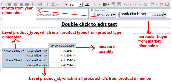

I am also attaching report definition and MDX that is created by Cognos BI. Any idea how to spead up performance?

- Cognos BI report definition created in Cognos BI Report Studio that executes report to get data from TM1 cube
- report_definition.png (26.33 KiB) Viewed 17015 times
- TM1 Performance Monitor
- cube_performance_monitor.png (9.02 KiB) Viewed 17015 times
