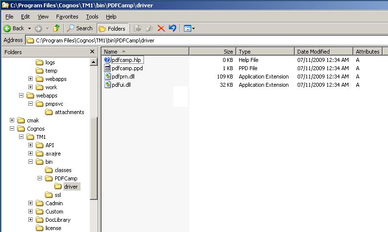

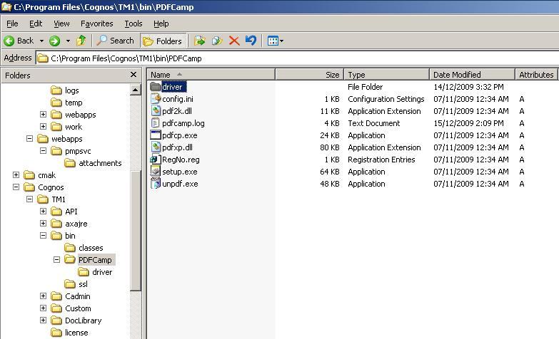

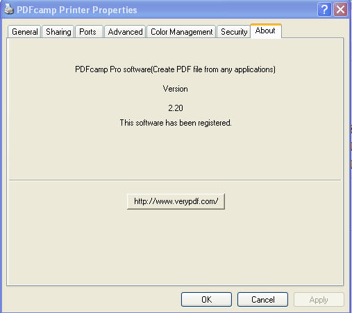

Are you in 32bit or 64 bit environment?
Sometimes in 64-bit environment you have to install the 64-bit version of PDFCamp. Have you checked the PDFCamp folder if it is missing any files? See the attached screens for the list of files you should have.
Also please check the PDFCamp printer properties (as shown in the attachments). It should say that it is the registered copy.
Else try reinstalling TM1.
- PDFcamp printer properties
- PDFCampProperties.JPG (30.76 KiB) Viewed 5455 times
- PDFcamp driver folder
- PDFCampDirectory2.JPG (49.96 KiB) Viewed 5455 times
- PDFcamp folder
- PDFCampDirectory1.JPG (60.59 KiB) Viewed 5455 times
