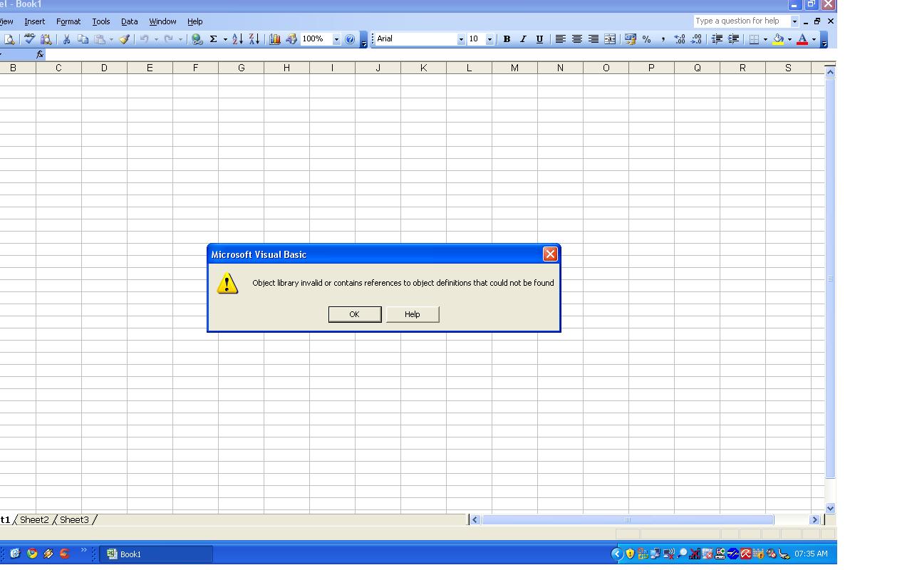

I recently re-installed Excel 2007 and 2003 and is using Cognos TM1 9.4.1 FP002.
When I open Perspectives in either one of the 2 Excel versions I get the following error message.
"Object library invalid or contains references to object definitions that could not be found."
And thus Perspectives does not load.
This is quite urgent because although I can work in Architect and need to create some reports in Excel and as we know that is not possible using Architect.
Can anyone please help!!!!???
Thanks!

If I were to uninstall Excel on a machine I'd be inclined to uninstall and reinstall Perspectives as well. It may not always be necessary, but better safe than sorry. My bet is that that would cure the problem.par3 wrote: I recently re-installed Excel 2007 and 2003 and is using Cognos TM1 9.4.1 FP002.

Re: Object library invalid or contains references to...
Guys,
I have reinstalled Perspectives close to a hundred times now after i reinstalled my Excel!
Still no luck!
Still no luck!

OK, next steps.par3 wrote:Guys,
Clean out yout Temp directory. You can access this by typing %Temp% in the address bar of Windows (not Internet) Explorer. You won't be able to delete everything (some files will be in use), but delete all that you can. Bloated temp dirs can cause havoc with Excel.
More specifically I'm suspecting a corrupted .exd file which is known to cause that error message. (.exds, but not the message, are described here: http://support.microsoft.com/kb/290537). If cleaning out the Temp dir doesn't do it, do a FULL search (including hidden and system files and directories) and blow away every .exd you can find. (As per the KnowledgeBase article, the files will be recreated on demand so there's no harm in doing that.)
Obviously do that with Excel closed and ideally Perspectives uninstalled.

My test box has just had a revised package for Office 2010 installed (originally Office 2003) and i had the same issue. The temp files made no difference but 1 EXD file existed & after deleting that all was fine again. Anyone changing versions of Excel who isn't having a clean OS installation would be wise to remove all EXD files before trying to use TM1. Its not just TM1 it affects either, probably most add-ins will get hit by it.

I just ran into this same issue with Excel 2007 and TM1 9.5.2. The root cause was 1-3 .EXD files, some of which were not in the TEMP directory (I just moved them all elsewhere without trying to figure out which one was at fault).

I had the same problem with Excel 2010 on a Windows XP machine with Perspectives 9.5.2. Due to an update of Excel, I got the same error as mentioned here. For me, this issue was solved by deleting the file C:\Documents and Settings\<profilename>\Application Data\Microsoft\Forms\MSComctlLib.exd.

Just came in Sunday evening to do some work on one of our TM1 severs, and got that same error.
Now I did not change anything (like install or reinstall Excel or Perspectives). It was working when I left Friday, and today I get that same error message as in the subject line.
The only thing different was that I had a windows message that my computer was restarted after a critical update was done.
I searched and found these 2 exd files on my system:
C:\Documents and Settings\tom.casey\Application Data\Microsoft\Forms\MSComctlLib.exd
C:\Documents and Settings\tom.casey\Local Settings\Temp\VBE\MSForms.exd
Deleting MSComctlLib.exd solved the problem on Windows XP.

Happened to me last week on a Win 7, Excel 2007, TM1 9.5.2 configuration. Plus I think a couple of other pc's are affected ( Win XP+ Excel XP + TM1 9.5.2).kevoni wrote:I had the same problem with Excel 2010 on a Windows XP machine with Perspectives 9.5.2. .... For me, this issue was solved by deleting the file C:\Documents and Settings\<profilename>\Application Data\Microsoft\Forms\MSComctlLib.exd.
Deleting C:\Documents and Settings\<profilename>\Application Data\Microsoft\Forms\MSComctlLib.exd sorted it.
