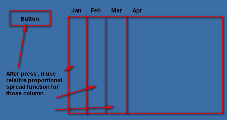

I have a template It have several month data.
Instead of use relative proportional spread manually for each month.
Can i add a button to my template to make it more automate?
After press the button , it call the relative proportional spread function automatically to get the data from perviod verson for those month
