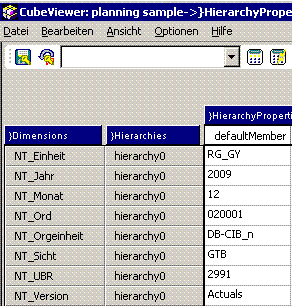

you may set the default memeber for each dimension in the cube "}HierarchyProperties". The according dimension "}HierarchyProperties" contains an element "defaultMember". This might help you in creating reports, if many of them have some default members in common. see attachment.
Nevertheless, when building your reports you have to take all eight dimensions of your cube into account. If you have built an eight-dimensional cube you had your reasons to do so. You can't ignore some of it when analyzing cell values. In Report Studio you can't just insert three dimension elements and hope that the software reads your thoughts and completes the remaining five.
