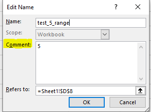

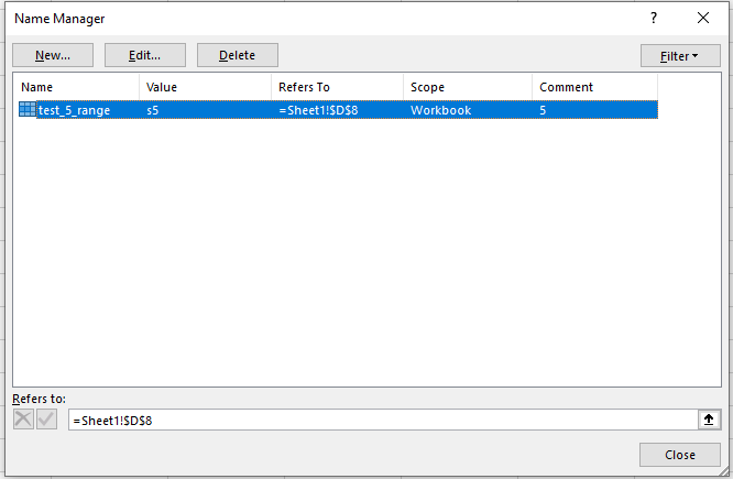

Re: PAX API: Multiple commit of all quick reports (or other ways?)
Hi Adam, Alexander,
Just a small remark. Names have a Comment field, that is exposed through VBA. Maybe useful to use that one rather than the string manipulations. Not for speed but rather ease of use/maintainability/flexibility.
In general, this Comment field and also controls that expose a .Tag property, are useful candidates to store this kind of information.
? Names("test_5_range").Comment
5
