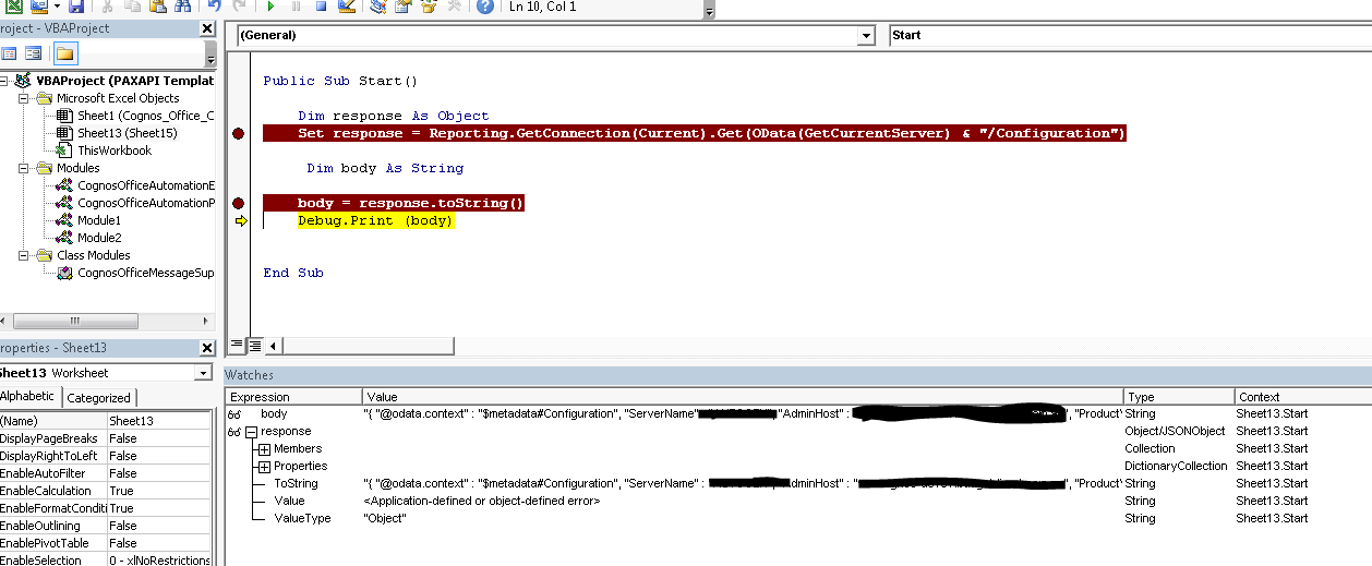

Hi, Dimix
Don't worry about JSONObjectWrapper and JSONParser functions. They are just dummy place holders which haven't been implemented actually here.
You can borrow third-party tools to parse JSON results, e.g. https://github.com/VBA-tools/VBA-JSON.
Basically, I put all of them into VBA modules, and get the response as the snapshot below. From here, you can parse JSON response and transfer them into excel values.
