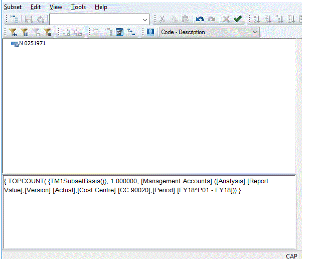

Re: Filtered by string measure in a 3 dimension cube
Posted: Tue May 22, 2018 9:53 am
by Steve Rowe
Hi Wim,
See below, you can tell the recorder is on because the Save button is greyed out. I seem to get the same behaviour irrespective of how I access the subset editor or the release
MDX filter record.gif (17.03 KiB) Viewed 11032 times
MDX filter record 2.gif (28.48 KiB) Viewed 11032 times
Posted: Tue May 22, 2018 12:20 pm
by MGrain
Hi Steve
The Filter by View Extract icon is greyed out in your last screenshot...
I see the same behaviour as Wim, as I press Record Expresssion, that icon and the OK button grey out.
Cheers
Mike

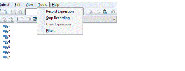

Posted: Tue May 22, 2018 1:20 pm
by Wim Gielis
I think we speak of different things.
There is Filter in the Tools menu, and Filter by view extract.
The first is possible when an expression is recorded (and can be useful), the second one is not enabled (too bad).
