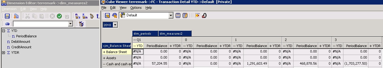

Hey guys ... I am new to TM1 and I am trying to replicate my balance sheet in TM1. What I am having a problem doing is creating a column for the YTD balance with is a sum of the balance of all the periods up to where you are.
I have tried a million ways and in the latest iteration I am getting an N/A in the YTD field. I have tried to follow the advice in this post trying to make YTD a consolidation of the periods in the rules but have not been able to get this to work. I would really appreciate if someone can teach me how to create a running balance step by step or see what I have done and tell me what I am missing.
I have also added an image to show what I am getting and how I have the measure dimension setup.
Screenshot
Screenshot
This is how i have the rule setup to calculate YTD ---> ['YTD']=ConsolidateChildren('PeriodBalance');
Any help is greatly appreciated!
btw I am running TM1 9.4.1
Re: Rules for Cumulative running Totals
Posted: Tue Jan 19, 2010 1:32 pm
by paulsimon
I would avoid consolidatechildren. Is there any reason why you cannot use consolidation in the dimension to give you YTD, as per the previous posts?
If the issue is that you have balances rather than movement figures, then a lookup cube that gives the last element in each consol could be what you are after, eg for Q1 it is Month 3, for H1 it is Month 6. The rule will need to work at all levels ie no N:
Paul Simon
Posted: Tue Jan 19, 2010 11:10 pm
by highroller
hey I was able to get it done on the dimension ... this post helped me understand what I needed to do http://forums.olapforums.com/viewtopic.php?f=3&t=1936 ... thanks a lot for the reply Paul.
