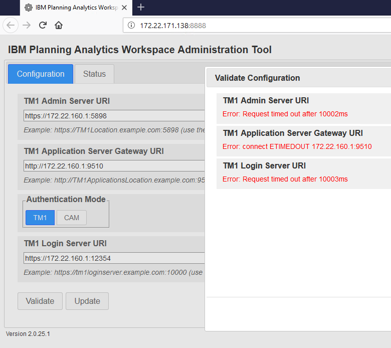

I'm glad I found your post as I'm having the exact same issue with an installation of TM1 & PAW on the same MS Server 2016 vm.
I have all the sample TM1 servers installed on Planning Analytics 2.0.3, but only have the Planning Sample TM1 Server running, & using its HTTPPortNumber of 12354 for the Login Server URI.
The PAW IP is 172.22.171.138 & the gateway is 172.22.160.1, but when I try this in the PAW admin tool config, I get timeout errors. True IP of the vm is 192.168.75.74.

Does anyone have any idea where I'm going wrong?

You may have to add firewall rules to permit it. Even communication on the same box can be blocked by the Windows firewall.
Try to temporarily disable it to see if that addresses the problem.

Hi dr.nybble
Fantastic, thanks for that...it worked! :D
