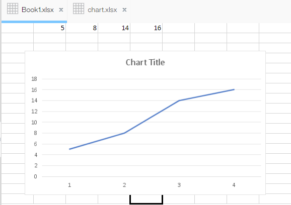

@Declan - would appreciate if you have 5 mins to create a basic chart like the one below-basically typed in some random numbers, highlighted, click on line chart, saved and uploaded then opened in TM1Web:

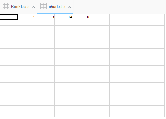

Took the same workbook and hid from row 105 onwards, graph not rendered-only difference between 10.2.2 FP4 and PA is that PA does not show the placeholder when "broken":
Thanks in advance
p.s. Book1 was with no rows hidden, chart.xlsx has hidden rows-apologies for poor naming.
