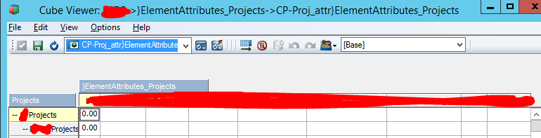

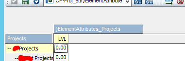

I am trying to write Project attributes to Database and have a question. I am looking for ideas on loading multiple attributes in one iteration of loop.
The cube is 2 dimensional (Projects and Attributes) and giving intersection values. Now, when I create a view, it gives one intersection point in each go. Instead, if all the attribute elements for a project loaded in a one go, I will have to make so many number of DB calls. Any ideas? Please let me know if there are questions.
If all elements are available in one iteration on the data tab, working would be simple.
All Attributes.PNG (17.57 KiB) Viewed 5943 times

One Atribute at a time.PNG (5.83 KiB) Viewed 5943 times

So, if not that way, the simplest way to do that is to use nested loop. The inner loop for all attributes and outer loop for all projects, if you know what I mean.

Paul-TM1 wrote: Tue Aug 07, 2018 6:23 pm if all the attribute elements for a project loaded in a one go, I will have to make so many number of DB calls. Any ideas? Please let me know if there are questions.
If the data source is a view then TI sees for data processing it as if all dimensions are nested on rows and processing of views is always one-cell-at-a-time. Therefore I don't get the point you are making.
An alternative would be to set the processing view with only one attribute and then on the data tab loop through the }ElementAttributes dimension. Or as already suggested outer loop of dimension elements, inner loop of attributes. If you want to include blank attribute values then this is probably faster anyway since the loops will be very fast and it avoids any overhead of creating and destroying the view.
