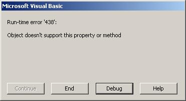

If I'm getting my value in a textbox, do I need to put double-quotation for it? Since I will be using the Textbox name, right?
Can anyone post a sample VBA script for creating a login prompt in Excel. I'm still studying VBA so I really need some help on this one. I'm not having any luck googling it up.
Private Sub CancelButton_Click()
' CLEAR BOTH TEXT BOX[attachment=0]Run-time Error438.JPG[/attachment]
        TextName.Text = ""
        TextPassword.Text = ""
End Sub
Private Sub LoginButton_Click()
' ERROR MESSAGE TO APPEAR WHEN CLICKING LOGIN BUTTON WITH NO NAME
        If TextName.Text = "" Then
            MsgBox "Enter your Username/ UserID."
            Exit Sub
        End If
' ERROR MESSAGE TO APPEAR WHEN CLICKING LOGIN BUTTON WITH NO PASSWORD
        If TextPassword.Text = "" Then
            MsgBox "You must enter your Password"
            Exit Sub
         End If
' RUN TM1 FUNCTION FOR LOGIN
        Application.Workbooks("Sales Cube By Current Product.xls"). _
        Worksheets("MainMenu") = Run("N_CONNECT", "Nexus", "TextName", "TextPassword")
End Sub

Re: VBA Macro for N Connect
Posted: Thu Aug 06, 2009 7:15 am
by Wim Gielis
Can you post your Excel file so that others can have a look at it?

Should your code not simply be this:
Application.Run("N_CONNECT", "Nexus", "TextName", "TextPassword")
(I think even the Application. bit is superfluous but I usually put it in). Not sure what the return value is but it's certainly not a worksheet ...

I still get the error if I copy what you wrote. I get a COMPILE ERROR: EXPECT: =
So I'm not totally sure how to make it work.

by Wim Gielis
You have to assign the result of the macro to e.g. a cell in Excel.
I usually have a function like this:
Public Function ConnectExcelToTM1(Optional blnConnect As Boolean = True) As String
    If blnConnect Then
        Range("Connection").Value = Run("N_CONNECT", _
                                        Range("TM1Server").Text, _
                                        Range("User").Text, _
                                        Range("Password").Text)
    Else
        Range("Connection").Value = Run("N_DISCONNECT")
    End If
    ConnectExcelToTM1 = Range("Connection").Text
End Function
This function is called like this:
Sub ConnectTM1()
    Dim s As String
    s = ConnectExcelToTM1(True)
End Sub
The disconnection would then send False as parameter. Additional error handling could be incorporated as you want / like /need.
The Excel cells (ranges) that I use have been given a clear name, rather than using cell references that could move when rows/columns are inserted/deleted.
Wim
