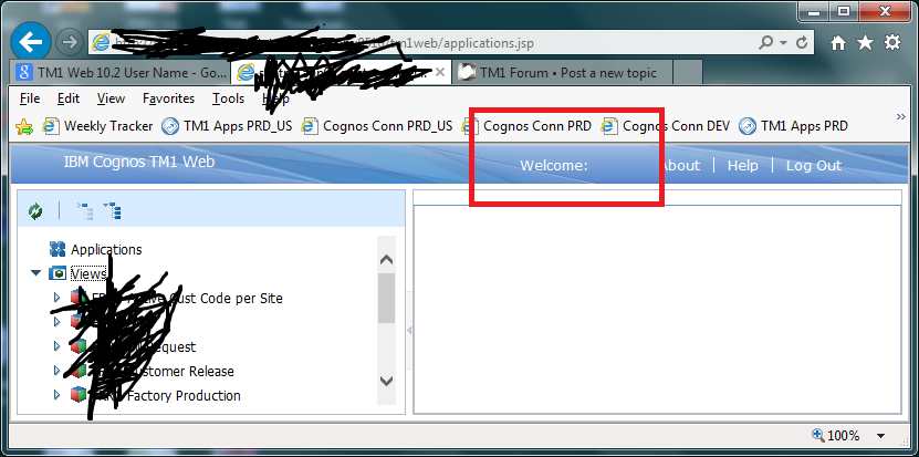

Hi Folks,
Just want to ask if this is an overall issue or if it is just me who encounters this.
We just installed TM1 10.2 and configured it to use Cognos Security. But it does not seem to display my username when I connect.
This is single sign-on.
See image below.
Thanks.
Bunch

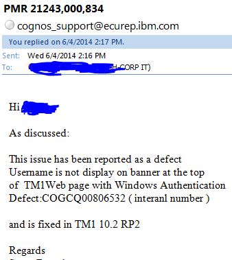

Hi Folks.
I raised a PMR on this. THis is the rep's reply.
- Capture.JPG (35.06 KiB) Viewed 15835 times
nick_leeson
- Posts: 98
- Joined: Sat Feb 11, 2012 11:13 am
- OLAP Product: TM1 9x, BPC, Hyperion, HANA
- Version: TM1 10
- Excel Version: Excel 2003 - 2010
Re: TM1 Web 10.2 No Username displayed
Can confirm this is fixed in TM1 10.2.2 also issue does not arise with CAM Security enabled.
