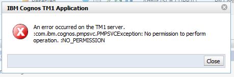

I created an approval-type application using TM1 Applications 10.1.1 (former TM1 Contributor). During our testing we came to this scenario when an approver owned the consolidated node Europe. (These approver and leaf-node contributors are all non-admin users).
Scenario:
Europe (Consol node)
Benelux (Leaf node)
Iberia (Leaf node)
Scandinavia (Leaf node)
Basically, all leaves became under the approver's ownership. But when the approver tried to release Europe (since Release icon is available), it prompted him a NO-PERMISSION error (attached).
NO Permission in Releasing.JPG (21.29 KiB) Viewed 5698 times

I am getting the same error as you described, did you ever figure out what was causing the issue? And did you have to develop a workaround?

The issue has been resolved. This was for TM1 10.1.1 FP3
Cause
The Users were Administrator's on one TM1 instance and Non-Administrator's on another.
Resolution
Ensure users are either Administrators or Non-Administrators across all TM1 Instances (at least for this version).
