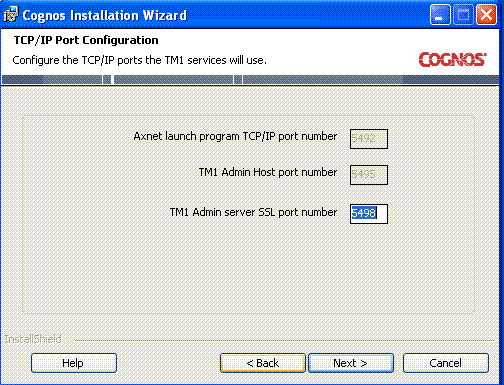

Re: 9.1 SP4 Not connecting to Server
Par3,
The port number is not in the config file.
Re run the install on the server machine and examine the attached screenshot.
The TM1 Admin server SSL port should be 5498.
If this number is different this could be your problem.
Herman
Herman
- SSL Port.GIF (15.63 KiB) Viewed 10662 times

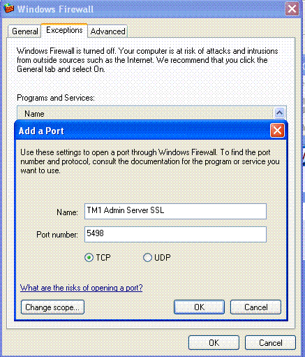

Par3,
I would also like to add because you can see the TM1 server on the Server, but no where else makes me think its is still a firewall issue. Try the following on the server.
Go to Windows Firewall and choose exceptions.
Choose a port number as below:
5498
If you open up this port from the firewall see if the user can now see the TM1 server.
Attached another screenshot below.
HTH
Herman
5498
HTH
Herman
- SSL FireWall.GIF (26.33 KiB) Viewed 10658 times
