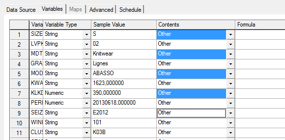

Or... select multiple boxes for Content, and change the Ignore to Other for the box that is selected but in white. See attached file.me2 wrote:You probably already know this but just in case: you can copy the Content setting from one variable and then paste it to multiple other variables in one go. Not as convenient as choosing your own default but it may save a few precious seconds nevertheless...Alan Kirk wrote:
How much time it has cost me to change variables from Ignore to Other since you can't set a default.
I Ctrl-clicked every other variable, and now applying the change for the 9th variable will change all selected variables.
Hence, you can also select the entire column and change the Contents settings for all variables at once.
This method also works for the Variable Type column (String or Numeric).
You would think this method also works in the Advanced > Parameters tab (the type being String or Numeric). Nada...!!! That would have been too easy.

I knew about the one mentioned by me2, but have to admit that I was unaware of Wim's one; that's probably because I have copying and pasting the whole lot down as muscle memory now. (Change the first one (and don't I love it that "Other" is juuuust below the bottom of the visible items on the drop down so you have to scroll to it), click, [Ctrl]+[C] twice just to make sure that it's picked up, hold down [Shift], select the last field, [Ctrl]+[V].) I'll start trying to develop muscle memory to use Wim's one since it's fractionally faster and since we're not likely to see any functionally useful developments in the Editorsaurus in this geological epoch.Wim Gielis wrote:Or... select multiple boxes for Content, and change the Ignore to Other for the box that is selected but in white. See attached file.me2 wrote:You probably already know this but just in case: you can copy the Content setting from one variable and then paste it to multiple other variables in one go. Not as convenient as choosing your own default but it may save a few precious seconds nevertheless...Alan Kirk wrote:
The thing of course is that I have never once needed to have a variable as Ignore. Sure, I do ignore some of them frequently, but I've never needed the contents type to be Ignore. Accordingly I generally change the whole lot to "Other" using the Copy / Paste method described above. You would think that they would all be left on "Other" by default. But no, because of course (a) the auto generated code selections must take priority and (b) nobody in Iboglix seems to have done any work on the Editorsaurus since the year started with a "1" rather than a "2".

In my case I use Wim method for variable content (select all variable and changing the one in blank). I'm so "brainwashed" than I didn't even think it could be the default value without the autogenerated code that nobody uses.

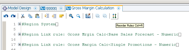

Both in 10.1 and in 10.2 PM you have the ability within a rule window to reorder the rules by pressing the rightmost button. Once they are reordered subsequent rule regeneration is supposed to respect the new order.lotsaram wrote:However the thing that really makes rule editing with PM untenable for me (more than the mind numbingly slow eclipse client) is the lack of control of rule statement order in the compiled rule file.
