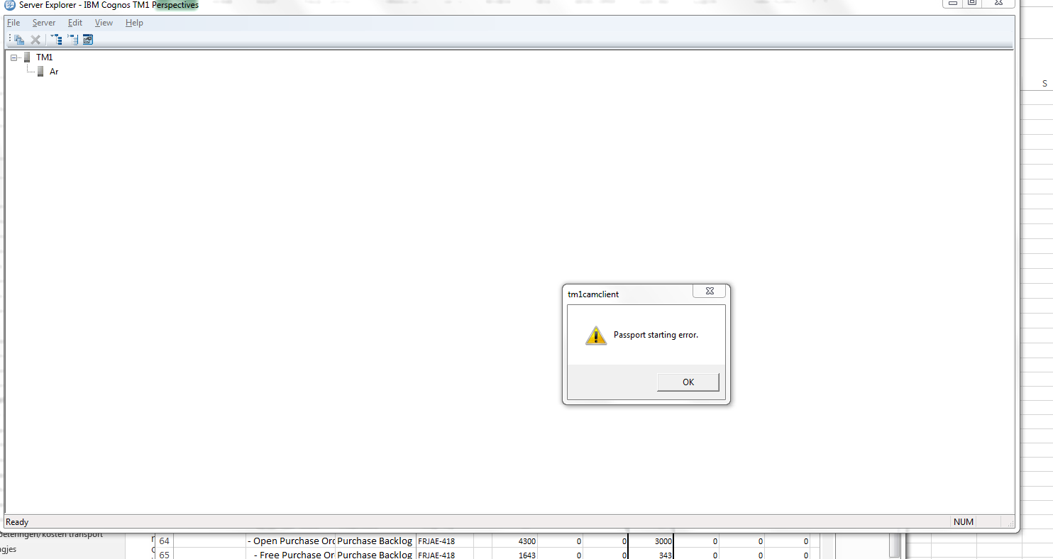

Hello All,
I have a problem with logging in in perspectives with CAM security and office 2013. At a customer we have several clients installed, Windows 7 office 2010 and Windows 7 and office 2013. All tm1 perspectives 10.1.1.
At all of the office 2013 installs I get the following message;
The other installs work perfectly. At all the clients loging in in BI and the tm1 applications portal is no problem.
When I do a google search or a search on this forum on the error message I do not get results on the specific message.
I posted it with IBM support, and I get the answer that Office 2013 isn't supported, so no help from them to be expected.
I know in some cases Office 2013 and Perspectives is working.
see this http://www.tm1forum.com/viewtopic.php?f=3&t=8867
Anyone of you any idea, other than downgrading to office 2010.
Thnx in advance!
Regards Sander

We've seen issue with the 64-bit install of office. Can you confirm that you have the 32-bit version installed?

Thnx for your reply!
Yes we have the 32-bit version installed.

Got feedback from IBM support;
I have heard from product management that Office 2013 will be supported in TM1 10.2 which is due out in September. The initial release will support 32bit Office only with 64bit support being added in a fix pack.

Hi Sandar
Did you get any luck with resolving the Tm1camclient Passport starting error?
We had an old 9.5 perspectives client that worked fine with Excel 2010 and gives this message now we have upgraded to 2013.
Have tried pretty much everthing suggested by IBM and have just got IT to drop DEP (data execution prevention) to a lower level, but to no avail.
When it goes to the server to retrieve the URL to authenticate through CAM it is not retrieving anything as a blank line is showing under CognisGatewayURI in tm1p.ini. (Normally this will be filled with the URL provided in Tm1s.cfg). (Also putting this in tm1p.ini does not help as it appears this string is held for reference only)
Any assistance from anyone who has resolved this would be much appreciated.
